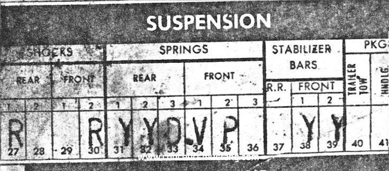

Will post a few 73 buildsheet sections here now that we've converted the thread from a single question to sort of a collection/display thread

From -3F01F1874xx
Projected build date - 12B
Body type - 2 Door Hardtop - 65D
Engine - 302 2V
Trans - C4 auto
PS - Yes
AC - Yes
Suspension (E41) - Blank- Standard
« Last Edit: September 15, 2016, 06:36:42 PM by J_Speegle »

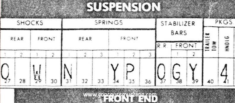

From -3F05Q228xxx
Projected build date - 01E
Body type - Sportroof/Mach I - 63R
Engine - 351 4V
Trans - C6 auto
PS - Yes
AC - Yes
Suspension (E41) - 4
