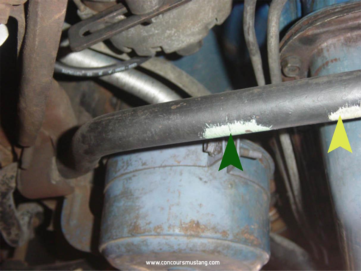

Front sway bar looks like it should be 1 green/ 1 yellow, where at? Rear springs are 2 yellow/ 2 brown, where at?
Green and yellow was a standard marking found on the big front sway bars 67-70 (GTs and Mach I's in general)  Picture is very flushed out

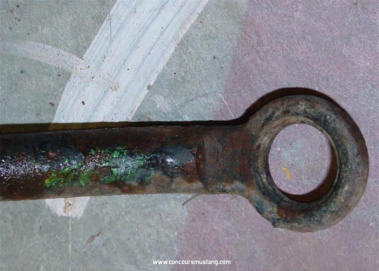

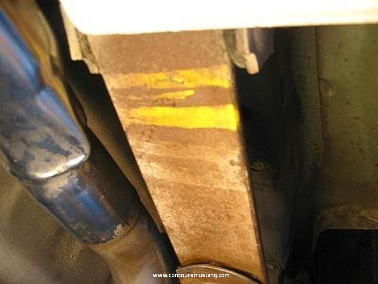

And a little extra for you
Idler arm - green stripe on mounting arm
Idler arm - yellow stripe on the moving arm
Pittman arm - yellow strip approx around the middle of the arm
Center line - yellow stripe around.
