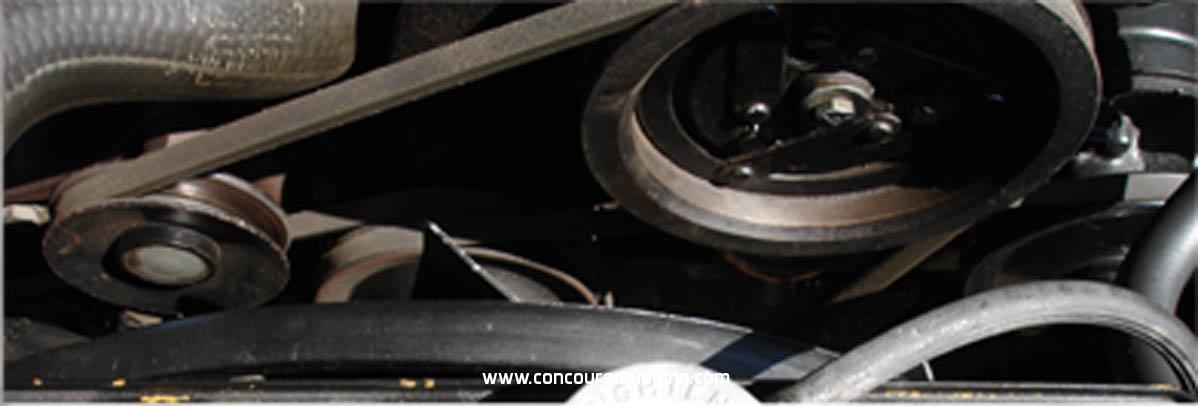

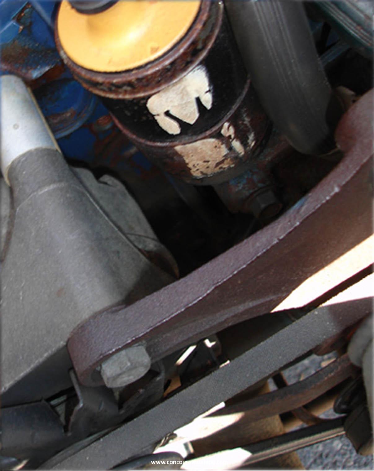

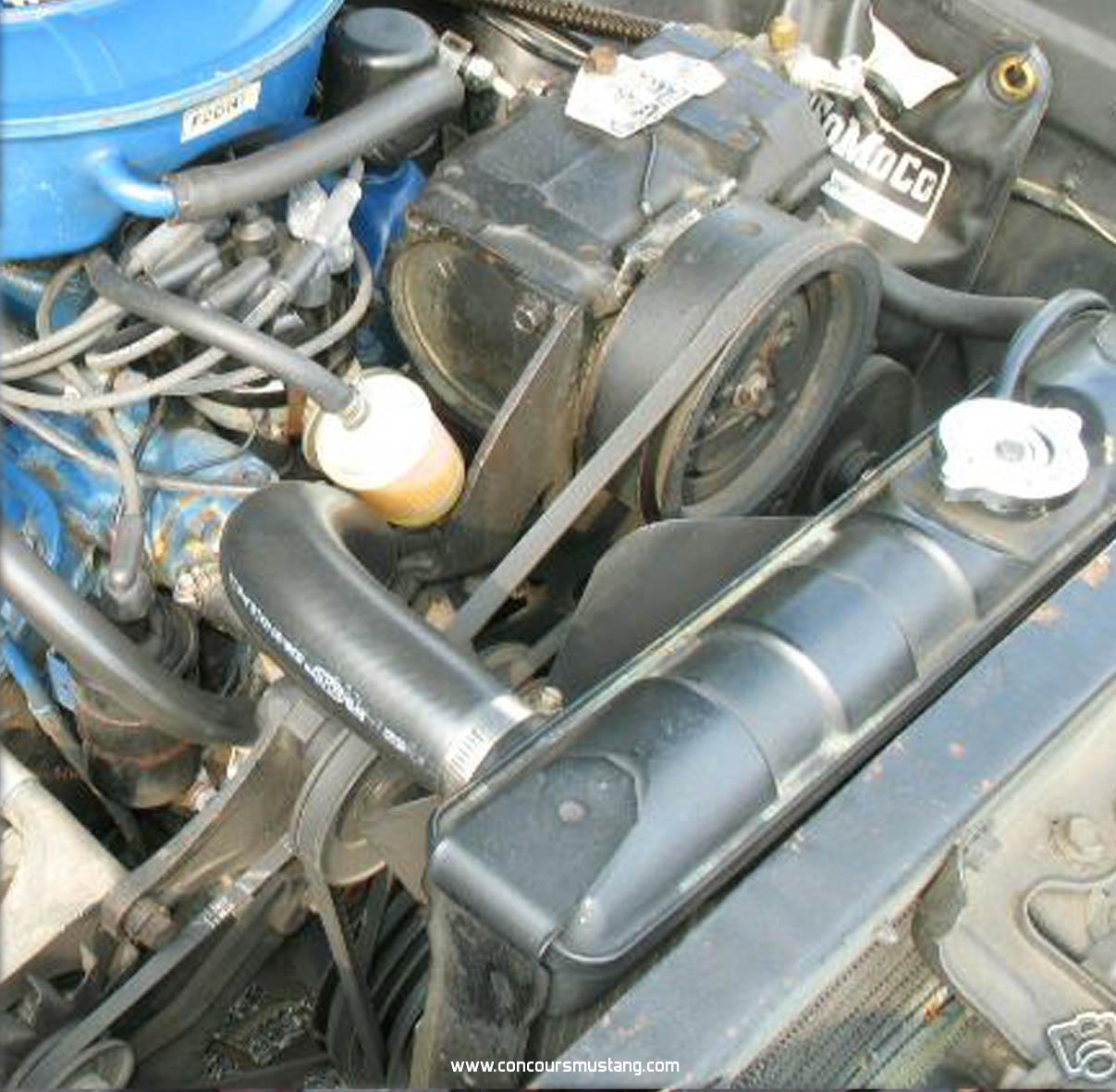

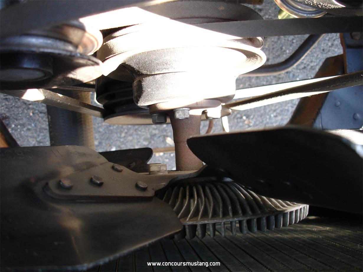

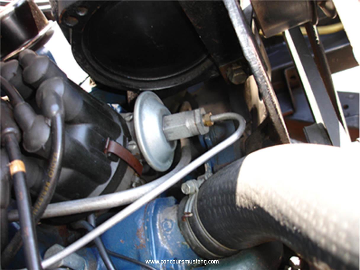

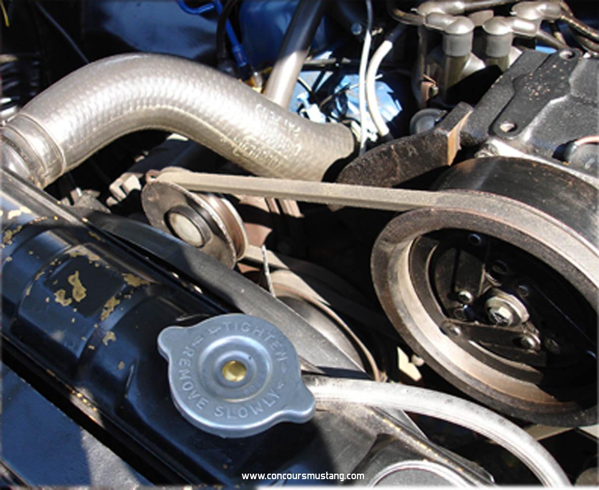

Hope one or more fits you needs. Not an easy area to get a clear picture of. If you need a specific detail please ask and I'll start looking
Pictures are from a late 66 San Jose  non- Thermactor, AC and PS V8 (12K miles) . Last picture is from an early San Jose car  equipped the same way

Thanks Jeff really appreciate the photos and all the advise, my car is an 15 October 65 SJ built GT Convertible.
Also noticed the Coil is positioned verticially on the front of the block, is the correct position. As l mine is located horizional near the carby.
Herman
Washing, polishing and cleaning stuff some more in an attempt to retain that 'Golden nugget'
Re: Alternator/Air Conditioning Idler pulley positions
« Reply #5 on: August 08, 2014, 01:25:58 AM »
It appears to be a difference between 289 C and A codes and if they were equipped with thermactor.
With thermactor there is no room at the front of the engine to mount the coil so it was moved to the intake - passenger side.
