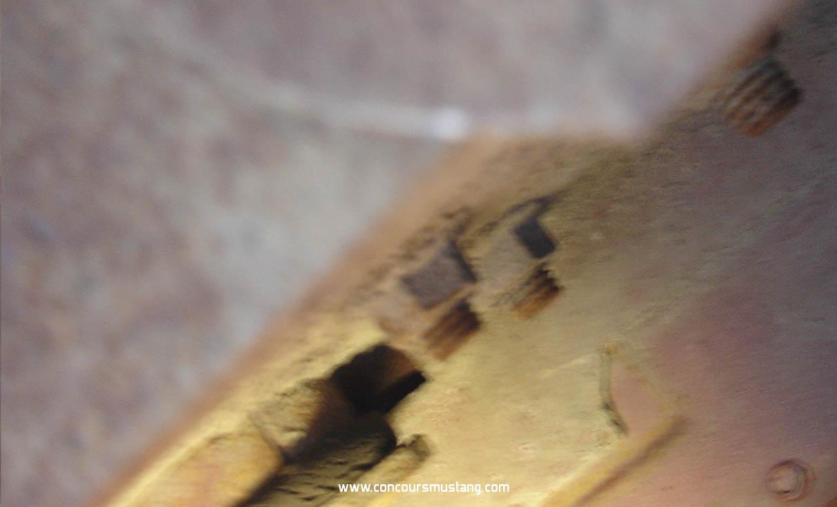

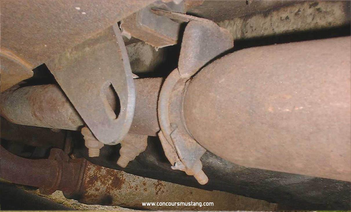

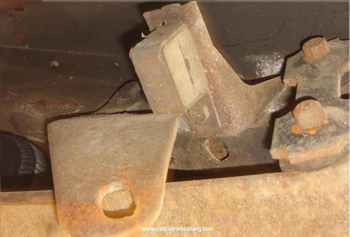

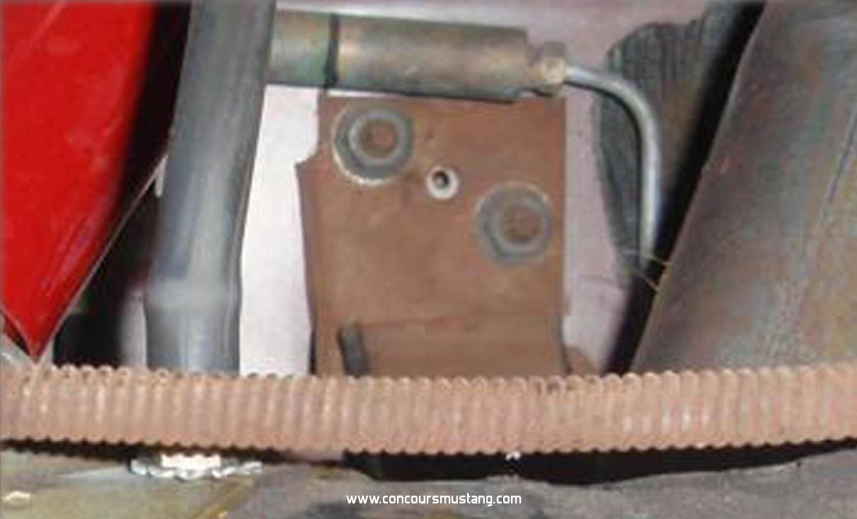

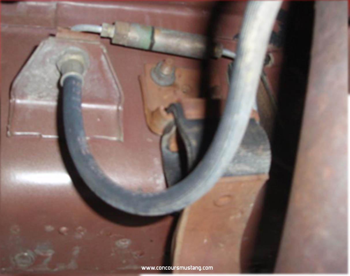

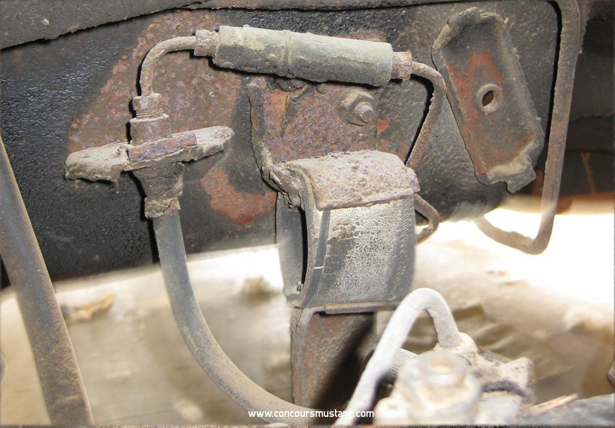

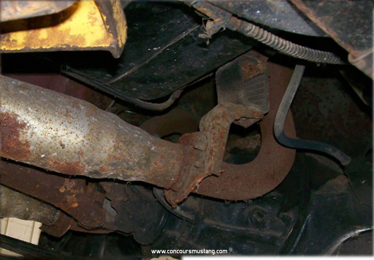

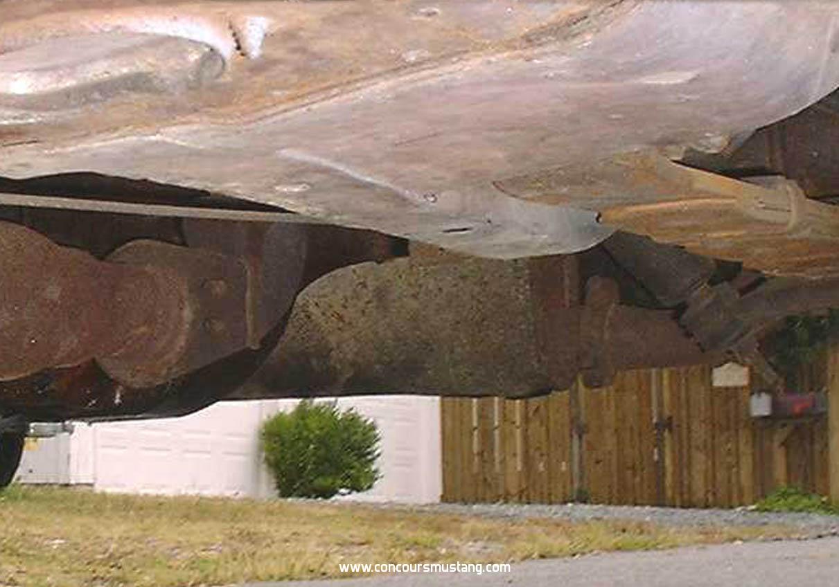

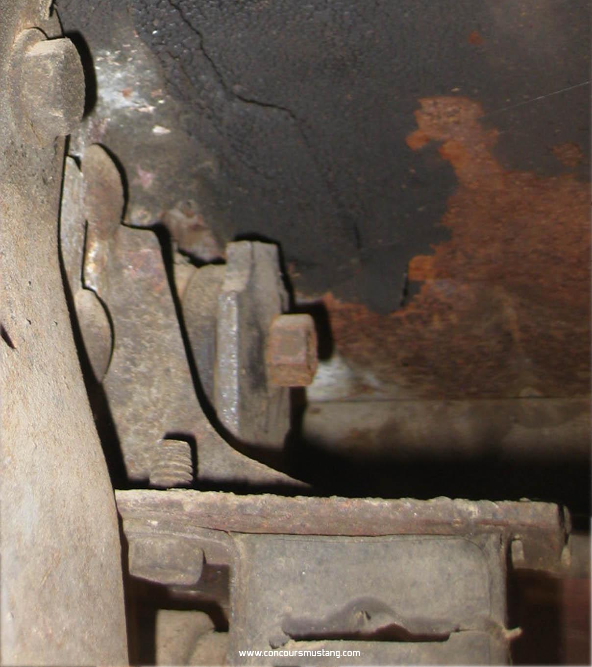

Here is a start - all 67's
Rear Mount/Hanger Nuts
Threw in a couple of extras - while I was scanning through the pictures
Hope these help

Thanks very much, exactly what I was looking to see details of. For example, I need to make another line for between the 67 rear mounted Proportioning valve and the rear brake hose. Nice to see it in there. Other details not seen still looking for, like orientation (rotation of clamps) at muffler, at Y-pipe, stuff like that. It looks like you posted a picture or two from 'other than San Jose' cars, very nice collection Jeff. I had before seen the Scott Fuller pictures, that did help with the unassembled pictures, so nice having a link to them.
Were 68's significantly different? Most parts listings do not differentiate from 67-69 very much.
Richard
Couple pictures there of the muffler and H pipe clamp orientation but will look for soem more

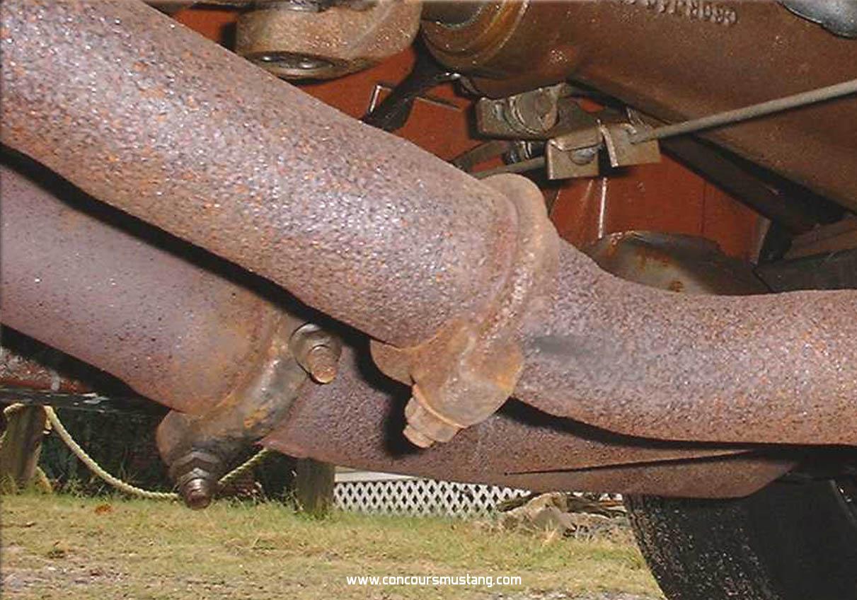

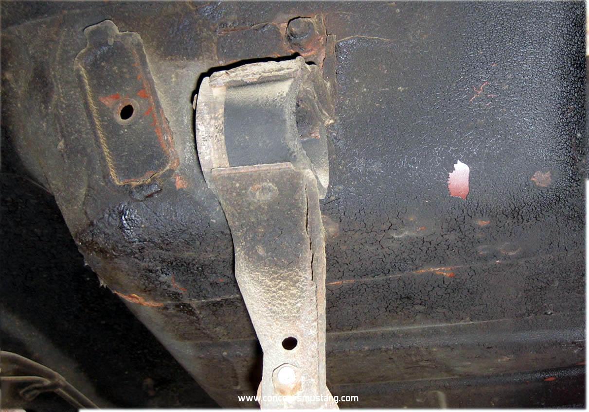

Here are a few shots of my Sept. 1966 San Jose Convertible's dual exhaust system prior to restoration.  Please note: the original pipes and most of the clamps had been replaced, and the muffler and quad exhaust tips were missing - but the transverse hangers, the L-brackets, and the J-brackets were all still there...
