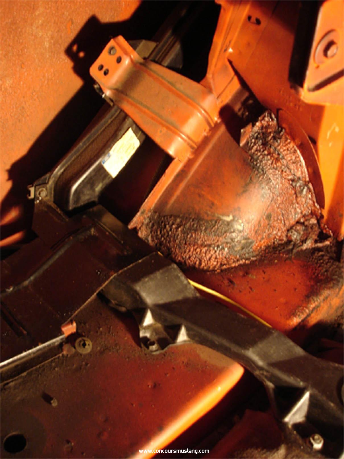

Shot of the trunk but with out disassembling everything not much help with the routing - holes are all under the protective plastic coverings
Dearborn example

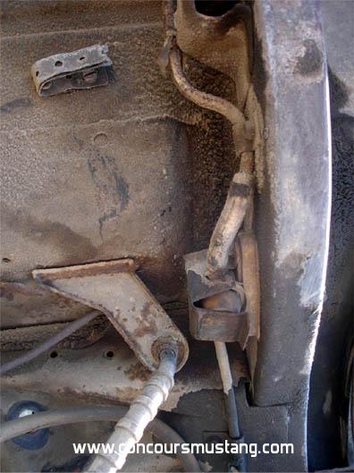

this pic is what I needed, just did not see it or realize it before. Any ideas or where to find that bracket and valve? Thanks

Mike has given you some good leads and choices. Every so often NOS items related to the system come up for sale - normally there is not a big demand and few people know what the part is - could get lucky there. In the short term - find a nice west coast piece(s) clean them up and use them. You can always up grade to better ones later
