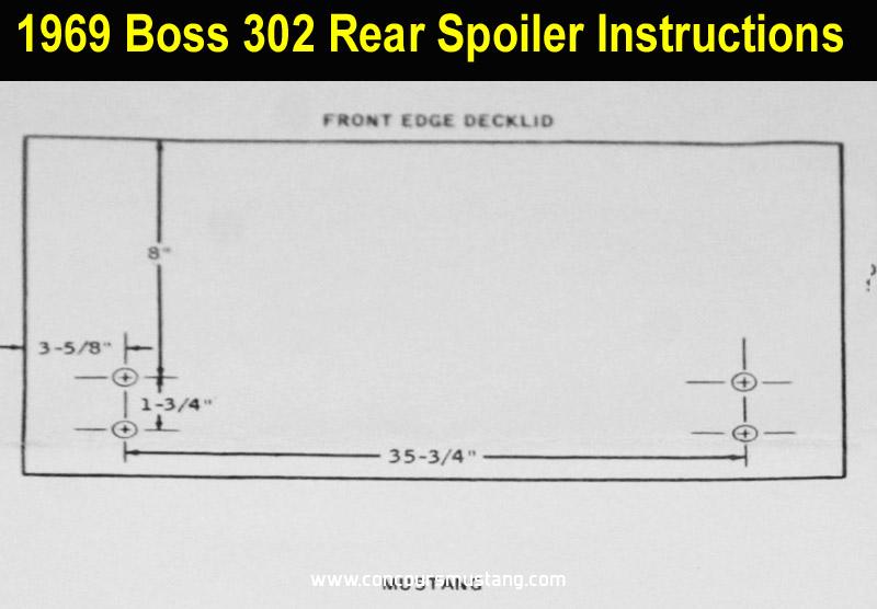

Thanks Bob
Reposting the measurements from the earlier post
« Last Edit: July 19, 2021, 04:26:55 PM by J_Speegle »

« Reply #31 on: October 29, 2014, 01:36:23 PM »
Yes thank you for posting.  Some interesting details.  Brian

Haven't measure the diameter of the outer and the inner holes to see if there is a slight size difference.
Well, now you know! :D
