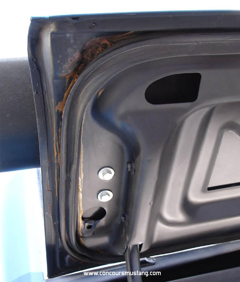

Ideally I would like to see the underside of the trunk lid with the spoiler installed to get a visual how they modified the trunk lid for the 69 Boss 302 spoiler installation.  I assume the trunk lid was modified for the spoiler.

Just four drilled holes, through the inner and outer skin with each one.   Will see what I have in the photo vault :)

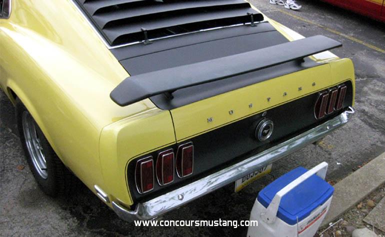

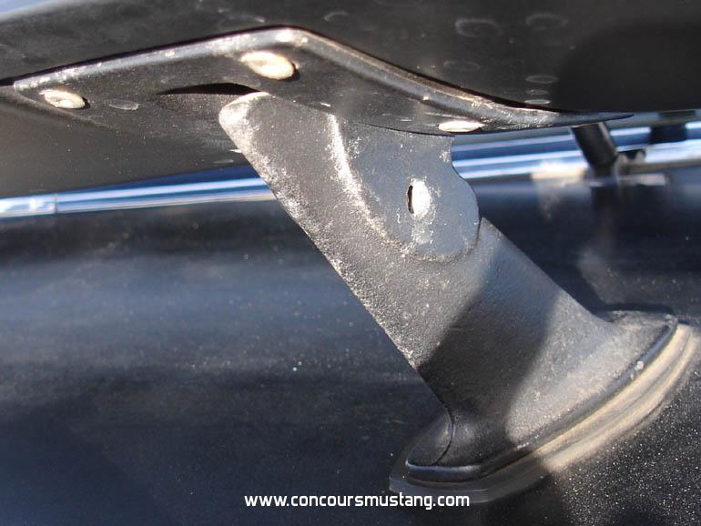

The challenge is that so many have been changed or altered in some way - or judge not great pictures. Currently mine has a 70 spoiler and trunk lid so can't use that as a correct example
Original (warped) rear spoiler/wing some other non-original details in picture

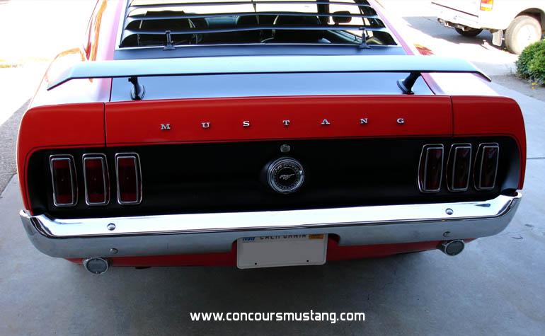

Another example

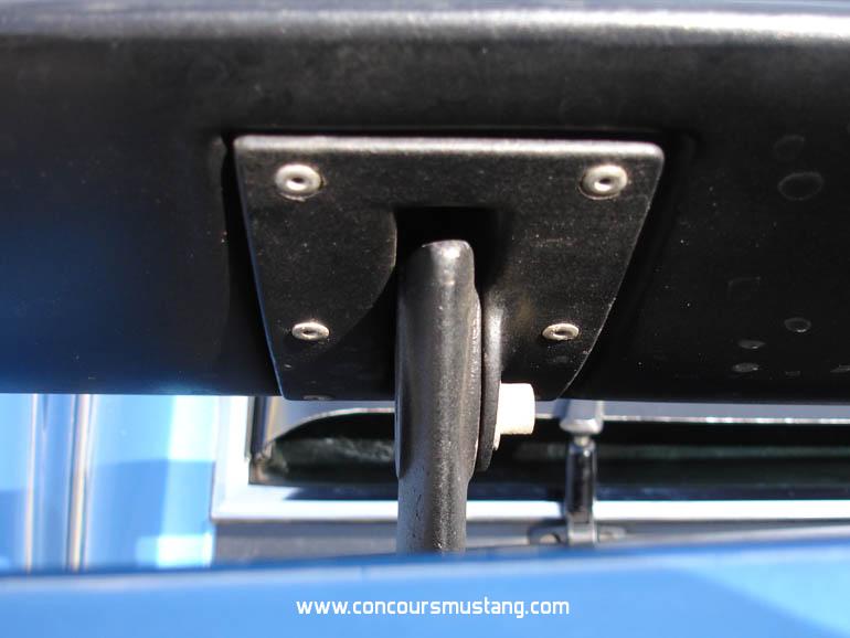

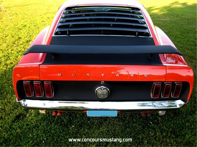

But other examples

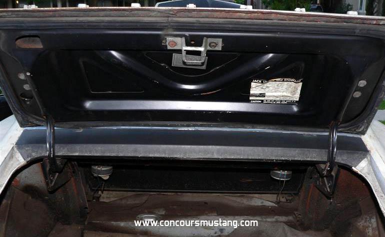

Right hardware - poor picture

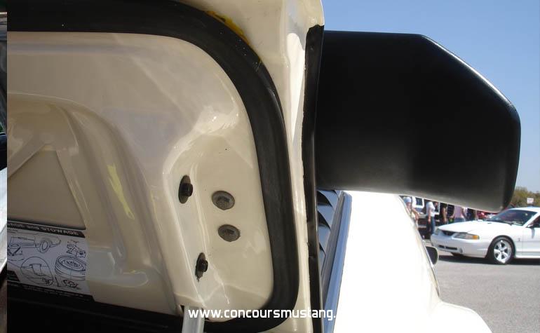

Right hardware - better picture - incorrect paint details in picture :(

Great pictures....thanks for posting.  So those spacers you posted earlier I assume were somehow put between the inner and outer trunk lid skins.

Well not exactly the hole that was drilled allows the spacer to be inserted, so technically they sit between the base or outer skin and the washer. Bleive the design/plan was that once tightened there was enough compression on the gasket to seal the water out and keep the spoiler in place.
Haven't measure the diameter of the outer and the inner holes to see if there is a slight size difference.

I would assume, (I loathe that word) from an engineering standpoint, that the upper hole would have to be smaller. I am suprised that this wouldn't be a fully understood (one way or the other) by the 69-70 experts here on this forum. Are there really that FEW orihinal examples with this spoiler in 69?
