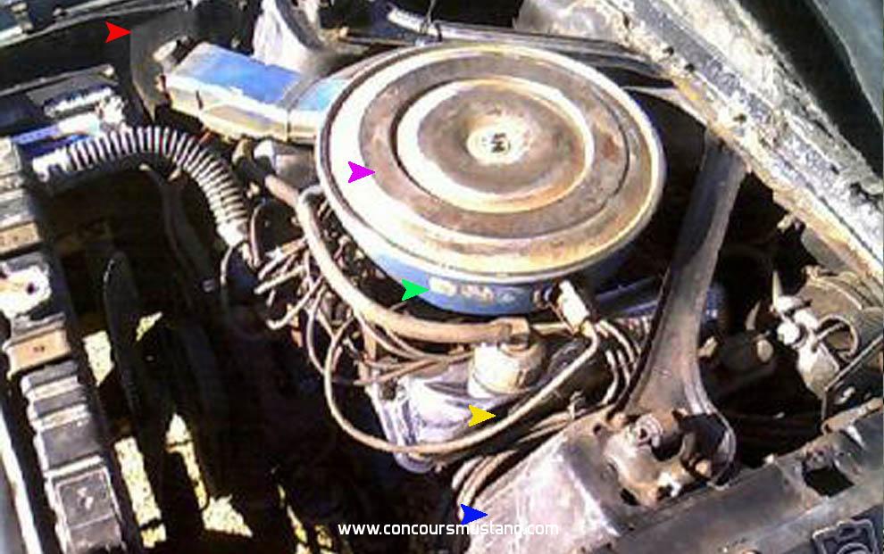

First step  - Identifying what decals are needed and locations
Red Arrow -  Battery inspection
Purple Arrow - Engine CU Decal
Green Arrow - AUTOLITE Filter Service Decal with Part Number for Filter
Yellow Arrow - Engine Timing Decal
Blue Arrow - Serve/Maintenance Decal
The engine compartment is the natural place to start, but are you also looking for trunk decal details?
This is a great picture/visual.  I can work with this.  I'm sure others will find it useful as well.
I see a lot of pics with the "FRONT" decal (white with black lettering) on the air cleaner as well...I assumed this was for a different application, maybe for an air cleaner without the snorkel?  Anyway, you've confirmed what I suspected...that the "FRONT" decal was not applicable for this application ('68 390GT with emissions).  Thanks.

Yes the FRONT was not used in 68 (nor most of the years) but it comes in the kit and owners will normally slap every last one on somewhere assuming that someone else knows more than they do. :(
Air cleaner top (CU decal) would be the two color decal (no white checkerboard) one.
The commercially available  battery inspection decal is vinyl not paper like original, has the wrong color printing and its not available filled out correctly from the dealers.
Since all had Thermactor there is no difference between the valve cover/timing decal and  cars built elsewhere. Do not know for sure if there is one version or multiples
For the Air cleaner, valve cover and service decals I would search out ESC products over Osborn ones. These can be purchased directly or many parts houses carry them - they will be the more expensive ones ;) or marked "concours"
Air cleaner top (CU decal) would be the two color decal (no white checkerboard) one. The commercial battery inspection decal is vinyl not paper like original and its not available filled out correctly from the dealers.
Thanks Jeff, the additional details are very helpful!
