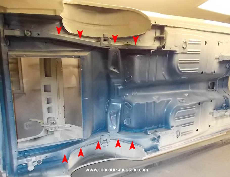

I'd like to get some feedback to see if this slop color looks about right, or whether it needs some adjustment --
A couple of observations
1-  Floor plan plugs would not have been in place (nor their sealant) when the car was being painted. so that should be bare galvanized with a black sealant around them. Same goes for the mounting screws
2- The sealant we see in the picture at the rocker to floor seam as well as the inner seat belt anchors would not have been applied before the batch color
Keep up the good work :)

Here's a few shots from underneath,
The color here seems to be stronger than its actually painted around near the front rails,  its a light blue-slop color, i'm not sure exactly why its showing up as strong.  its misted over a natural color
69 428 GT -- 9F02R -- build date 10/11/68
Re: '69 painting questions (Oct 68 Dearborn)
« Reply #23 on: March 09, 2015, 09:27:20 PM »
Is this the same color you used under the car from firewall rearward?
Is that light gray in the shock tower area?
Since you don't have documentation of how your car came not sure if I would have chosen the batch over the red oxide (more common)
Looks like your going to need to reapply the frame color back in the wheel well, then feather the body color and black back over the areas as shown in the attached threads.
« Last Edit: March 09, 2015, 10:46:36 PM by J_Speegle »

« Reply #24 on: March 10, 2015, 12:52:53 PM »
I'll get a better shot of the shock tower area.
As for the red-oxide,  we used CobraJetChris's picture as a guideline since that was painted one day earlier (10/10) at the factory.
As for the wheel well -- thanks!  That's the question is was going to ask to make sure i was reading the other thread correctly.
