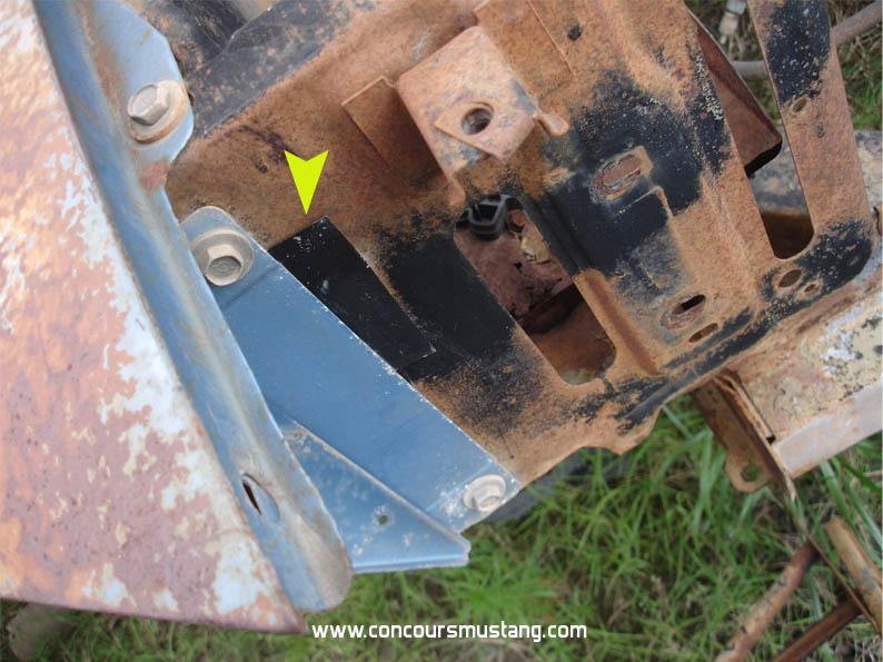

Part of the fun fielding questions here is that I don't only have to answer the question, I've got to find a picture or two to illustrate the answer - well mot of the time ;)
Normal location  of a 69 Dearborn buck tag
Appears that this (pretty original car) 70 Shelby's is still in that location
hard to make out (black on black) but if you look real close you can see the edge of the tag as it sticks out from under the fender bracket

The tags were typically removed . They unscrewed leaving only the hole most of the time , they were unceremoniously ripped off leaving the screw and a portion of metal from the torn tag sometimes , and the least common from what I have seen was left in place (maybe slightly moved ) while the fender was attached .On unmolested cars you can sometimes see the witness line of unpainted metal from where the painted tag was slightly moved when Smith installed the fenders. They were in the way many times which is why the variations.

I think you'll find it was more early cars that had them. Should be bare metal patch where it used to be on removed ones

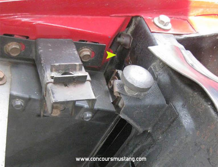

yes first 100 or so tags got left on  & vinman has  p ic of the upper fiberglass headlite bucket screw going thru the tag left on an early 69 Shelby as that is why tag was removed as it was in the way for installing fiberglass bucket on rh side.   jeff s  it looks like screw hole in your red Shelby pic don't have tag attached to me as the small hole from buck tag panhead screw is empty.

.........  jeff s  it looks like screw hole in your red Shelby pic don't have tag attached to me as the small hole from buck tag panhead screw is empty.
Believe that like many/most of the 69 production the screw is located under the fender. This is that red 500 that we all looked at during SAAC a couple of years. Was located between the hotel and show area at the end of the row in the middle of the driveway

looks like the screw hole at 12 oclock of the rubber hood bumper  & Shelby used that 2 bolt silver shield that holds plastic splash shield & on your red Shelby pic it is mounted  on back side rad support.

. Shelby used that 2 bolt silver shield that holds plastic splash shield & on your red Shelby pic it is mounted  on back side rad support.
Yes understand the plate and location - not sure what it holding it in place - wish the pictures were clearer - blowup from a general picture of the area.
Not a big deal considering we've had confirmation that some got by the AO Smith workers
Will look to see if I have a better picture of that particular area

try this possible scenario- fender was installed and sometime later a inspector ,past owner etc. saw the tag and thought by taking the screw out that the tag would be able to be removed . After the screw was taken out it became apparent the tag was being held by fender structure . The screw was never screwed back in. I know this has scenario has happened at least once because I was a past owner in a similar scenario years ago with a car I previously owned except I replaced the screw when I couldn't get the tag off to read. ;)
