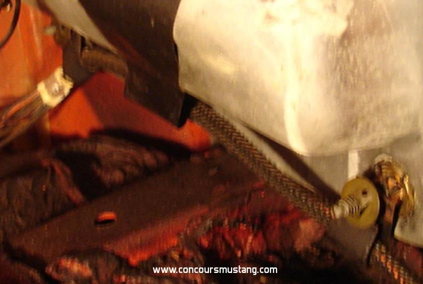

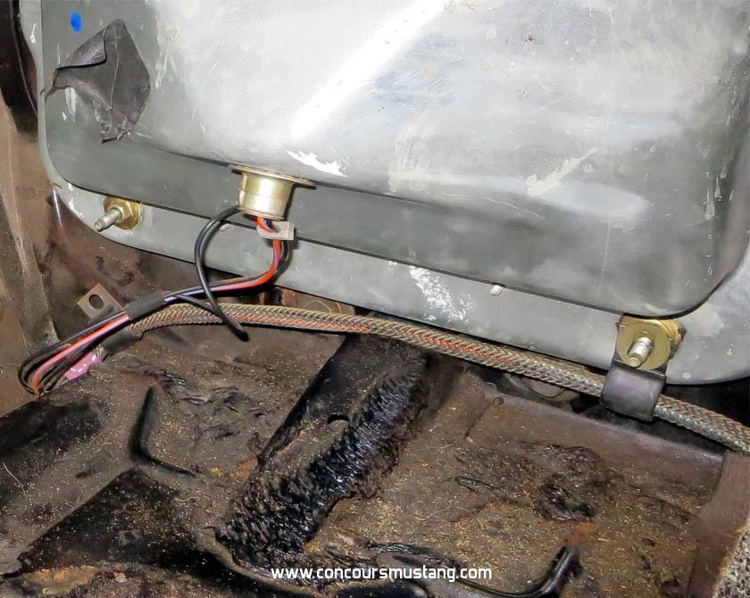

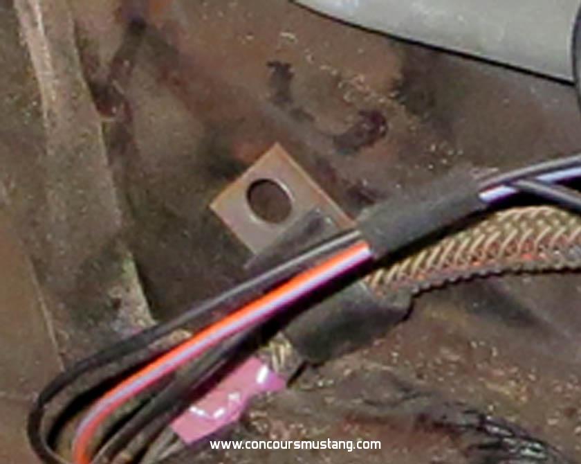

Found different ones on very early cars but for the time period your looking for the pictures below should help with the design and look. Looks like you need 4 unless you have the California vapor return system
0F03R123xxx Appears that one of the retainer speed or slip nuts came off
0F02G15xxxx

Had to find some pictures (not easy as that corner is hidden under the taillight and allot of brackets and stuff to get in the way)
Appears by my examples that there was not change to the one far driver's side mounting point. Since I had not found or looked at that earlier I left that detail open to cover my bases ;)
