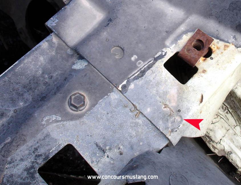

Some shots that will surely provide a better idea than my words could ;)
On this one the arrow shows the original black/engine compartment paint edge. Ignore the other black - someone with a rattle can :(  int he past

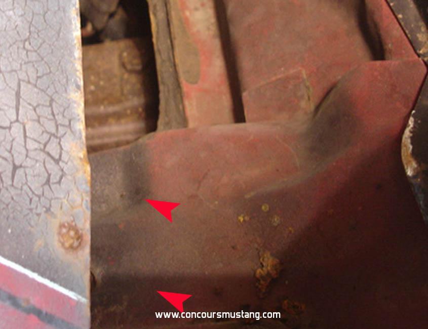

Originally some of those parts would have been red oxide front and black (other than the head light buckets) The amount of overspray from painting the exterior and mating surfaces would have differed in amount based on the painter. Have examples where the back sides are as nice (fenders) as the out side or just enough to account and reflect what was being painted on the exterior - more around the wheel well and the bottom of the fender directly above the wheel well, back at the door opening, on the front bottom inner surface from painting the face and lower section where the front valance would be attached
As far as rear valance normally not allot of overspray normally since it was difficult for the paint to get there (normally more at the wings) since it was attached at the top to the body when the car was being painted. But after light gray primer surfacer coat ;)
To add to the list you would have the
- cowl cover
- lower panel for the grill opening (you can often make out the paint shadow from the two sections that sort of hang down at the front edge.
Other "back side" would be the quarter extensions but like the rear valance they were sort of on the body come exterior paint application - just spaced out a 1/4" or so
