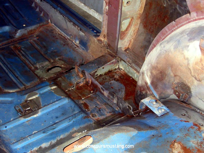

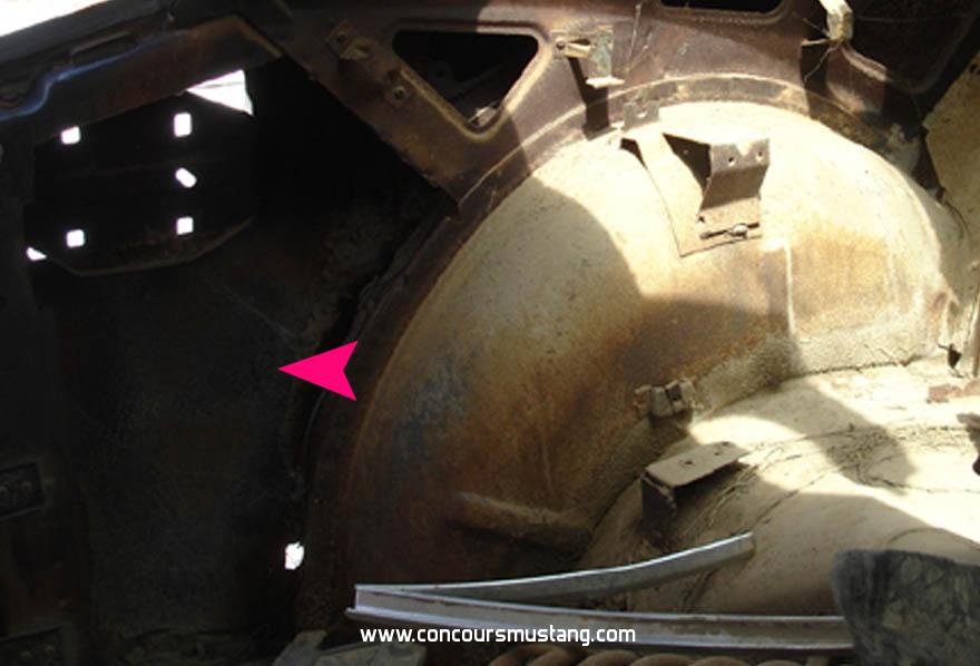

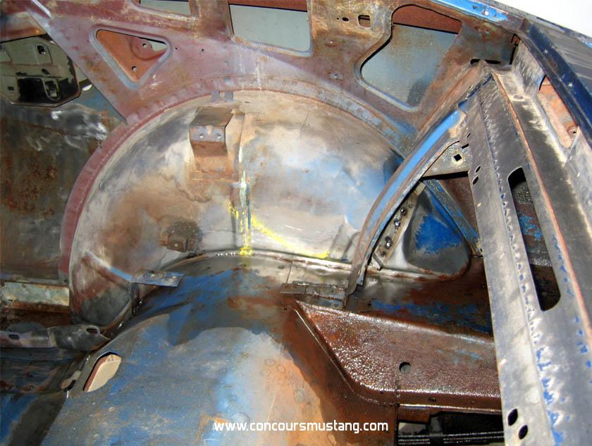

Will admit that I haven't gotten allot of calls for interior finish information over the last 30 years so I don't take as many pictures of these (not seen once the car is together) details
Looking at other "early" 69 Dearborn built examples it appears that the side area (where the kick panels will go) that Chris posted pictures of is pretty typical though later in the year this practice was dropped. You still find that allot of restorers do black out this area just because it looks better on a finished car even if it was not originally done.
The examples I found were built before and after your car so with Chris's example it covers the practice well at this point
Blue exterior car
Red oxide and darkened area
As for other "black out areas" on a sportroof at Dearborn 69, looking at my pictures it appears that that plant and time they didn't do what other plants and months in relationship to addressing those other areas
So addition interior shots from the first half of 69 production at Dearborn
Matches my description above as far as interior overspray of exterior color. Amount of overspray can differ allot

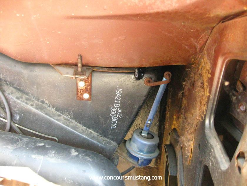

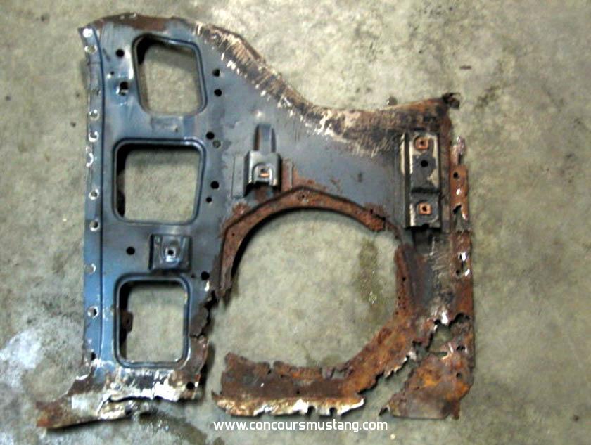

I found some more photos that may help as far as the interior area of the firewall. Like the photos Jeff has it was red oxide. The area around the VIN tag was not originally blacked out as you can see in one of the photos however I did fudge on that a little and blacked it out for appearance reasons like Jeff mentioned. It just looks better especially on a brighter color car contrasting a black dash board. I found a shot of the lt. qtr. panel inside area with the sound deadener applied however the rt. qtr. panel was replaced at one time so not sure if it was applied there but I went ahead and applied it on the rt. side when I restored the car assuming it was there. I guess the thing that surprised me the most was the extent of the coverage of the slop blue metallic undercarriage color. The entire underside and engine bay was painted as you can see in areas the seat bolt access hole covers were removed along with the shock tower cover bolt head areas. The transmission tunnel and rear frame rails had good coverage also with a good amount of body color overspray applied.

Jeff, in the interior shot of the images which Chris posted, i'm seeing grey slop painted on the interior kick panels,  and it doesn't seem to be overspray,  was this typical?

.............I guess the thing that surprised me the most was the extent of the coverage of the slop blue metallic undercarriage color. The entire underside and engine bay was painted as you can see............
Yes remember your pictures - yours is one of maybe 4-5 that we've found that had the additional use of the batch color at Dearborn in 69. Something much more typically found on 70's at that plant.
