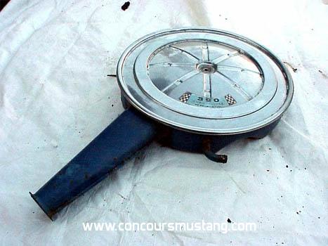

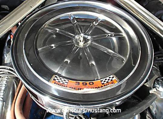

Hi Jeff  - thanks for the links. Now I know where I “thought” I saw a clear sticker. It was in a picture in one of those threads. Upon closer inspection, it was faded blue. Again I am looking for
non-smog, late December, SJ.
However in the third thread above, I found this picture
http://www.concoursmustang.com/forum/gallery/8/6-080917180944-8659384.jpeg
Is this due to the later build date? I can’t tell on my phone, but that air cleaner maybe had the snorkel removed, and maybe a chrome base and nipple.
Is the picture just for placement of the decal? I see that decal on the raised  ring of the cover, other pictures have shown it inside of the raised ring... just curious.
http://www.concoursmustang.com/forum/gallery/4/6-061015171045.jpeg
After reading numerous threads and hundreds of pictures, they kind of blur together. I have no idea how you do it.
Thanks!
« Last Edit: September 26, 2017, 09:22:24 AM by BKnapp »
‘67 390 Coupe A/T  P/S  P/B. (Built 1/4/1967)  7R01S145xxx
‘67 390 FB A/T P/S P/B (Built 3/10/1967) 7F02S173xxx
Re: 67 390 GTA - Air cleaner decals
« Reply #11 on: September 26, 2017, 02:43:13 PM »
The two decals have a different circumference so they were placed in two different locations it appears by the workers.
The first example does appear that a PO had chromed the bottom base but the intent of the picture and focus was on the top factory lid, the style of decal and placement for that discussion and I think if fits here also.
There has been allot of discussion over the years about which air cleaners were used and installed at San Jose on 390's in 1967 and only one reference has been found which suggests that the choice was based on a trim package (GT/GTA or non GT/GTA)  but that hasn't always matched what has been found on unrestored cars over the years so we've kind of left it there since earlier discussions appeared to hit a wall until we find a bunch of new unrestored examples
So that is one detail you left out of your description of your car. Is it a GT/GTA or not?
