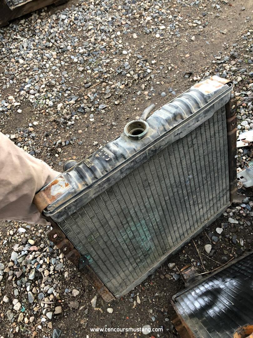

Jeff, I think your round-top bracket radiator pictured here may be a 16-inch radiator (I-6 example?), noting what looks to be the wider side bracket at the lower edge of image (not completely seen in this image).
Aside from this, my understanding is that any 289 with Thermactor & Select-Aire would have Extra Cooling option (also K-codes too, even w/o Select-Aire). Other 289's WITHOUT Select-Aire would typically receive a 20-inch STANDARD cooling radiator. I have not seen any 289's with a 16-inch radiator (though I would never rule this out for Eastern/Midwest DSO's). I did not look at the MPC to confirm any of this, only reporting my personal observations over the years which were mostly Western DSO examples.
I'd agree with Richard, which is why I think the radiator below looks to be a good match for my '67 C code car with C4, AC and T/E.  It needs servicing and repair, but I'll move forward.
I wouldn't say it is exactly a perfect match but feel you may be safe in saying it is "a good match". I believe what you may have there is a STANDARD cooling radiator but as a core, it can be used for parts to achieve a "perfect match" to your build information.

Thanks Richard,
I haven't had the opportunity to compare side-by-side, a 1967 20" Standard radiator with an Extra Cooling radiator so I can't comment about any differences.
Agree, the radiator is a good find that I'll plan to use on my car.  I have the original side straps with the curved corners which I plan to swap.  For background, the car currently has an aftermarket Modine core installed in 1981 to replace the worn out W MO radiator.  The original radiator was discarded (1981 - who knew!), however the original straps were reused on the Modine core.
Robert

I think we are in agreement that the rounded corners not sharp corners are correct for a '67 20" radiator.  Below is a photo of the old radiator currently in my car.  I plan to re-use those rounded-corner straps shown in the pic on the repaired W MO 66-9 radiator when it's installed.

Duece,  I don't mean to be argumentative, but I would give a second look at the straps you plan to use.  There is even a bigger difference that I see - if you will note how the original factory straps have a bump up across the strap before making the turn down the side,  Which these do not have - they are flat.  (the original soldered on tag lays right along this recess).   I have seen Modine replacement radiators with the flat style strap.
Personally, I would use the tank and straps from the core you found - they look right.  (I really can't see what you mean by square corners - maybe a better straight from top photo would help)   At any rate if they appear too squared off, a little radiusing with a file should do the trick.
The main difference in standard vs extra cooling radiator was in the fins per inch specification and otherwise look the same.
Hope you see what I'm saying - Kurt.

« Reply #28 on: December 04, 2018, 09:01:29 PM »
Kurt,
I would agree, some basic filing work would do the job on those straps. Then I can use them, along with the soldered-on tag.
Thank you for the explanation of differences between Extra Cooling and Standard radiators: a higher fin count per inch on the Extra Cooling version.
This info will help to achieve the correct results on the finished radiator.
