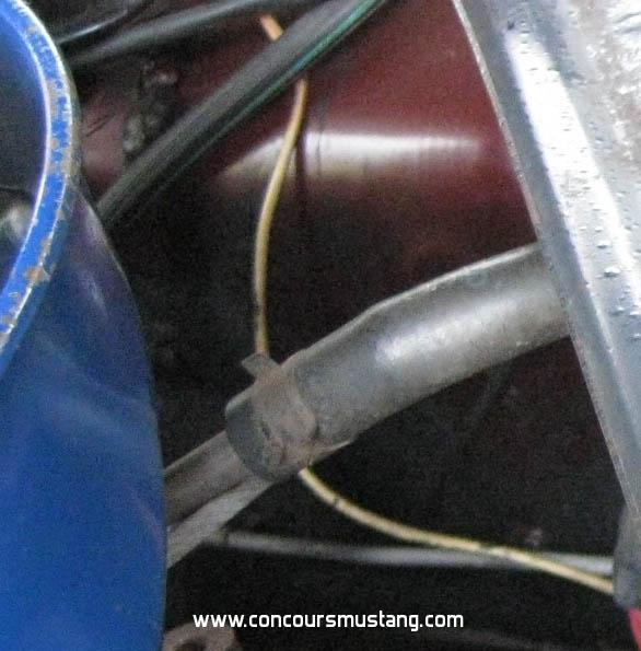

More correct though the finish is still different than a couple used
One in use ;)  - Different year
