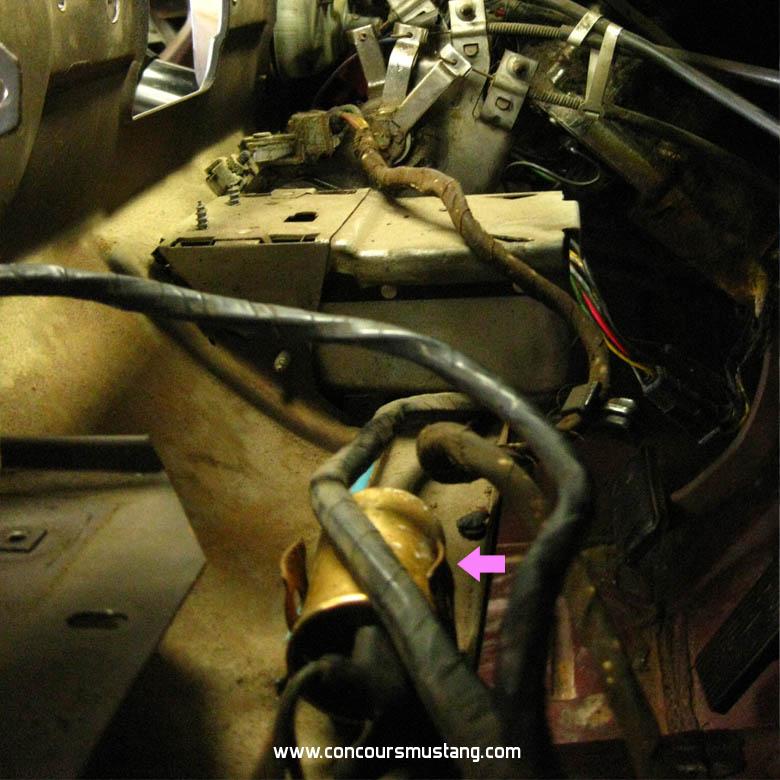

My '66 vert is pretty much an original unmolested car... I bought it from the original owners. (An old Couple in their 70's at the time).  I'll get a pic up of the plastic holder up ASAP!.  It also has the look/feel of a Ford Made part with Ford Hardware... Not some dime store auto parts store.
First Pic.  "Supposed" Factory installed clamp and position as found before disassembly.   I took this pic in 2008 as I was taking the dash apart many years ago.  If you look closely in the pic, You will see a long Black Human hair trapped under the clamp.  That was as found.  It was probably from the 60's Hippie at Dearborn who assembled the dash...lol....and Yes, I know about the "Non-Original" Metal patch in the Front floor board...lol..
Second Pic.  Taken today. 2/8/2016.  The part was still out of the car, So taking a pic of it was easy!...  Here it is.  It sure looks like a Ford part to me.  It looks like its made of the same Nylon plastic that Ford used. It also has Ford made attached nut and bolt.  Judge for yourself....and let others respond.
I have to admit, It's not a part that I have thought about much over the years...  I had a June '66 Dearborn Hardtop that I sold a few years ago, and I seem to remember it having the same part..
Thoughts?
You're the seconds person I've run across who has this exact same Plastic Clip...now I wonder which is correct. I'm about to post my own question about a Clip that I have, whether or not it's correct and where it mounts.
