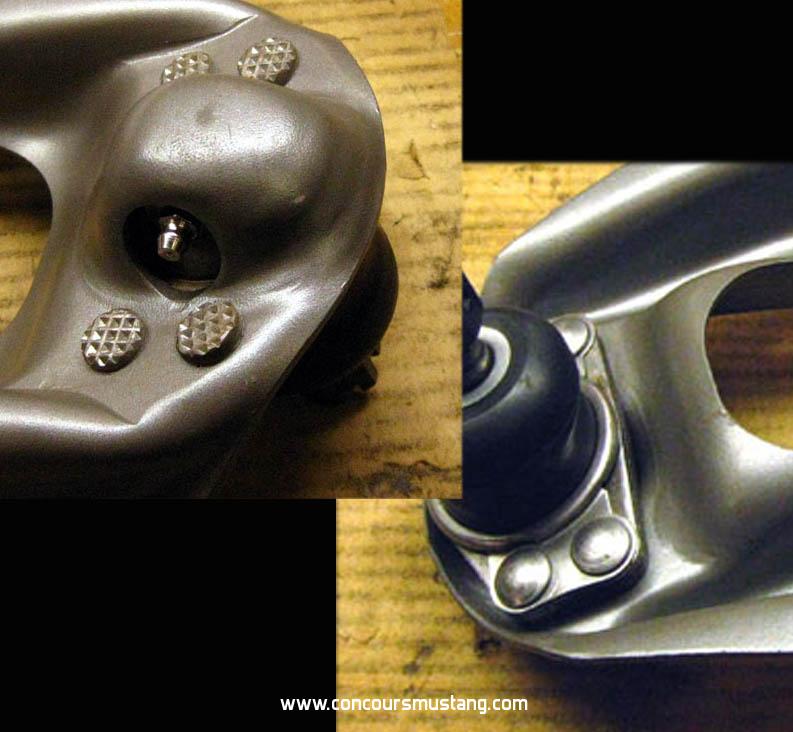

Re RIVETS: Thanks for the input to this point. I see that especially for the waffle pattern I need for my build information ON THE UPPERS, it may be best done by somebody who already has the tooling. As I get the arms ready for the riveting, I'll make that final decision when ready. (Still holding out for a source of riveting tool recommendations)

Attached are 2 pictures borrowed from a renowned Restorer's website including details I hope to duplicate to whatever I ought to do given my build date. Regarding the UPPER control arms, that site only looks to have pictures of a 68-69 version so hardware details would differ (red dye on nuts NOT used on 67's).
Below the two "borrowed" images, are two more images of my original arms, partially stripped down.  You can see evidence of paint under the strut rod mounting and all the way to the tip of the arm suggesting that the whole arm was painted black after assembled. I had never removed these arms completely before, I once replaced the lower inner bushings right after I bought the car (1978) and this was done without removing the arms from the car. After that time, nothing was ever done to the arms.
Any sort of time frame this is correct for that we understand for the SJ cars?

Still just spit-balling ideas...I cannot imagine nobody has tried these ideas and perhaps since the ball-joint riveting is a safety-related item AND an item many PROFESSIONAL Restorers do as "Services for Hire", my replies are limited out of liability or financial concerns but if anyone has experience they may be unwilling to share publically, please consider private messaging me as an alternative.
Riveting tools like this for duplicating the waffle pattern are out there, so obviously, individuals are doing such work: http://www.macsautoparts.com/ford_model_t/waffle-tool-for-setting-body-rivets-use-with-air-gun.html
 At about $30 each tool, I see it becomes cost-prohibitive quickly for most do-it-yourselfers. As mentioned earlier, I often change ball joints for hire so I wouldn't mind outfitting myself to do riveting work on those jobs too. Many ball joint kits have cheap bolts provided that I end up replacing with harder bolts for safety issues.

I don't see how using that air hammer bit would yield desired results.  Maybe after pressing with a flat bit and then using it as a finisher?

Jeff, does rare parts have the parts and ability to do this job correctly ?  -Concours-
Sorry this took a couple of days - and example of the rivets (waffle patterns - one of maybe a dozen available)  done at Rare Parts (upper A arm style) for comparison
Please ignore the scratches and marks left in the metal - not the focus right now ;)
Original 69s from another thread for comparison
« Last Edit: February 05, 2017, 06:29:53 PM by J_Speegle »
