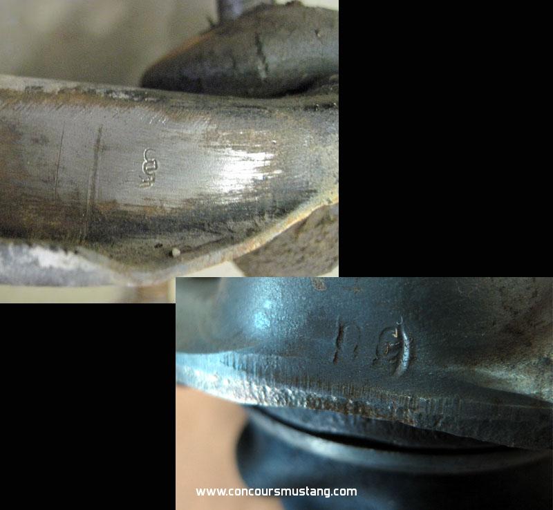

I could have sworn that Charles T. had posted pictures of UPC and LCA date stamps on a thread , but regardless the markings are many times overlooked because they are typically so faint that they are easy to miss or are not visible at all from my experience. After blasting and tumbling cores the faint stamping will apparently disappear given so many cores end up without any. The generic looking simple marking is easy to duplicate if one needs to see them. In concours I would not deduct if they are not seen (Thoroughbred or SAAC Premiere /DIV I ) given many are to faint to be distinguished originally.

« Reply #33 on: May 27, 2019, 07:25:12 PM »
A couple of examples both lower and upper to illustrate.
Upper A arm one is just about impossible to see on an assembled car but we the owner or builder knows :)
