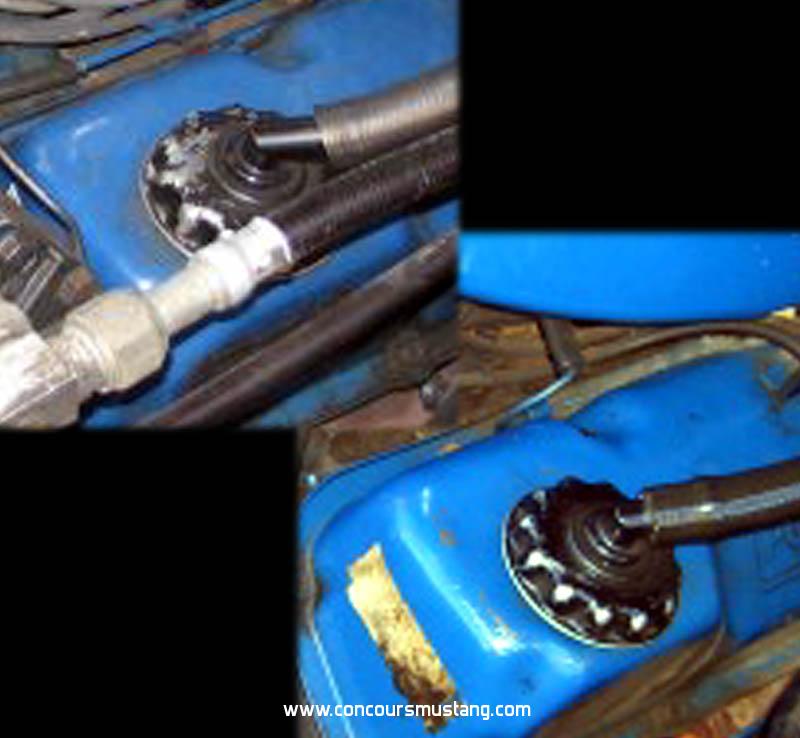

Should the grommet above the main wiring in the fire wall have something going through it or should it just be a blank plug?
My engine fan has a big gap between fan & shroud at the top and the bottom of the shroud is broken it looks like the engine sits to low do those engine mounts look right for a cleveland? I want to put a new fan shroud on.
« Last Edit: May 09, 2018, 09:14:13 AM by Blown351stang »
  • Posts: 24861
Re: 70 MACH1 Engine Bay Questions
« Reply #13 on: January 01, 2017, 03:59:53 AM »
Believe it depends on what options, accessories, and other things the car was originally equipped with
My engine fan has a big gap between fan & shroud at the top and the bottom of the shroud is broken it looks like the engine sits to low do those engine mounts look right for a Cleveland? I want to put a new fan shroud on.
BTW the stater cable bracket should be attached to the end end of that upper rubber mount (at the block) not down at the bottom
As for the frame mounts I'll see if I have some pictures to share not sure if your going to be able to tell from just looking
Should the starter cable be between the motor mount & block or exhaust manifold & mount?
