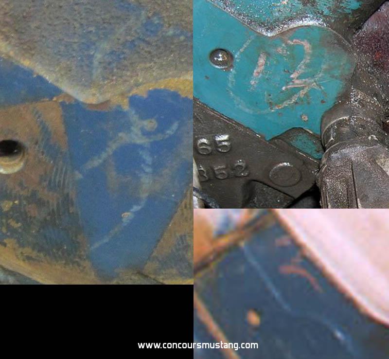

Took a look and could only confirm (number of examples that all had the marking) what appears to be a number on the forward face of the drivers side head surface.
Appears that they were applied (likely the difference was a different worker) with a circle around the number and without.
Number was single or double digit.
Applied more often (according to the examples I have) in white crayon marker

REQUEST  to other viewers: Please do not use or copy these onto your car unless it is a 1967 with a 390 or 428 originally installed. Every time we share these details they turn up on something completely different. For that reason I often don't share them in public but will give this a try.
Here you go Rossco - this should help

« Reply #7 on: September 09, 2017, 06:44:08 PM »
Jeff
what can I say.... greatly appreciated, I understand the value of these photos
Ross

Upper right photo looks very familiar.    No need to copy when you have the original.   ;)
Jeff has an amazing collection of photos!

Thanks... I find it interesting that the shades of blue are so varied on those pics.

Would not suggest that is a great take away or the colors you see are correct and true.  The difference is likely just the camera settings and other things that take place when you take and use digital tools to save and manipulate photos as we've warned/mentioned before

Jeff, have you determined a meaning for the numbers ?

Best guess would be that it identified with an final inspector or the line the engine was assembled in. We already have the initial of the assembler on the completed engine so not much left
