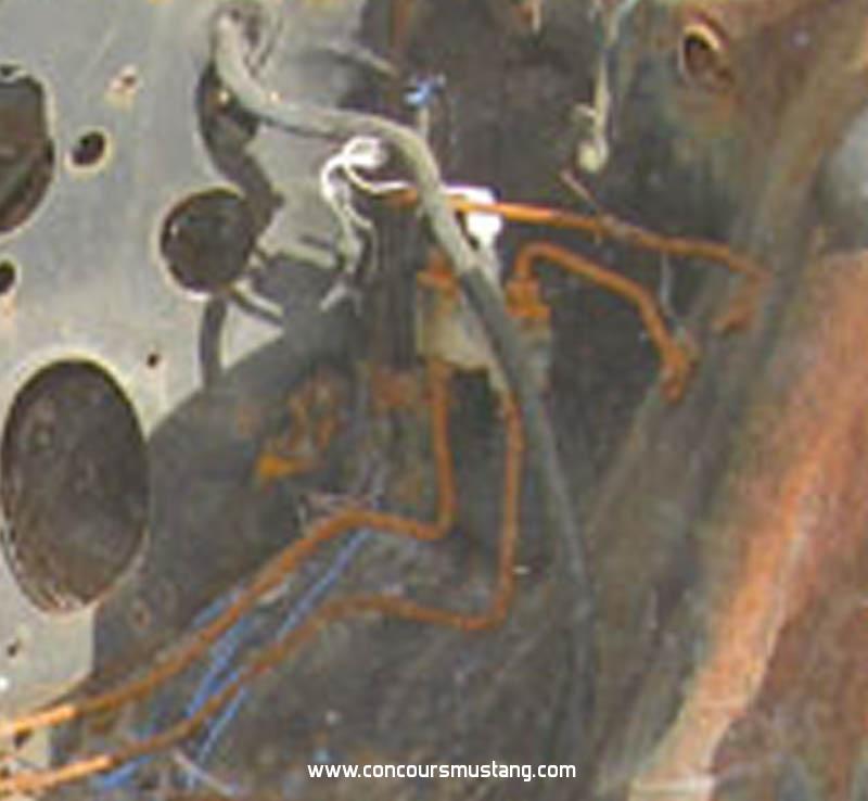

Offline bazza
  • Posts: 98
Re: Very late 67 proportioning valve
« Reply #9 on: October 01, 2017, 08:18:26 PM »
I did find these pics in an earlier thread, don't know its application.
Jim, does it look familiar?
67 Dearborn S code coupe Built 8/17/67

I've just found this pic in this post. This is the distribution block I'm looking for information on.
http://www.concoursmustang.com/forum/index.php?topic=15440.0
« Reply #14 on: October 01, 2017, 10:52:28 PM »
It was about the change of location.
It is also the "different junction block" assembly that I'm looking for information on.
Seems the valve itself is the same between early and late.
Doesn't look like that would apply to a very late Dearborn 67. Think there is some confusion here. Could not find any 67's within months of your stated build date with one of these
