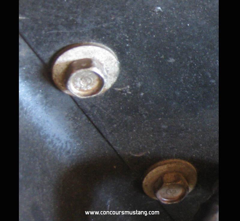

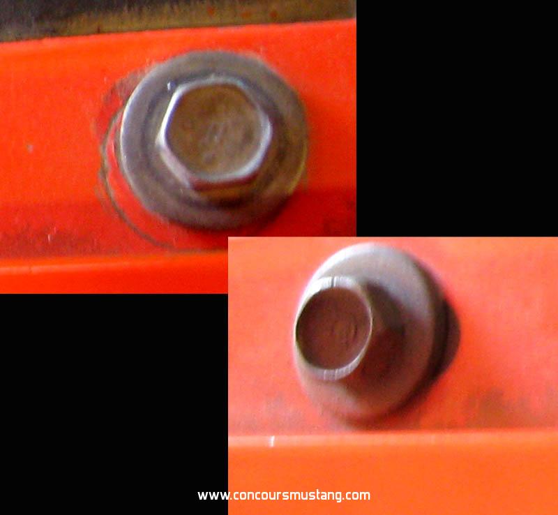

Bolt head design #1 (small flags)  & #5 (circle L's) were were the ones I found were used in the 140000-150000 range in 1970 production at Dearborn
On my best example there was a mix on the fender attachment.
On the spring cover/shield attachment I found all #5's
Re: 70 Dearborn fender bolts
« Reply #11 on: December 28, 2017, 08:24:02 PM »
And all appear to be Grade 5.1.
As specified, they should be cad plated. As cad plating is falling out of favor, try a dull zinc finish after bead blasting.
