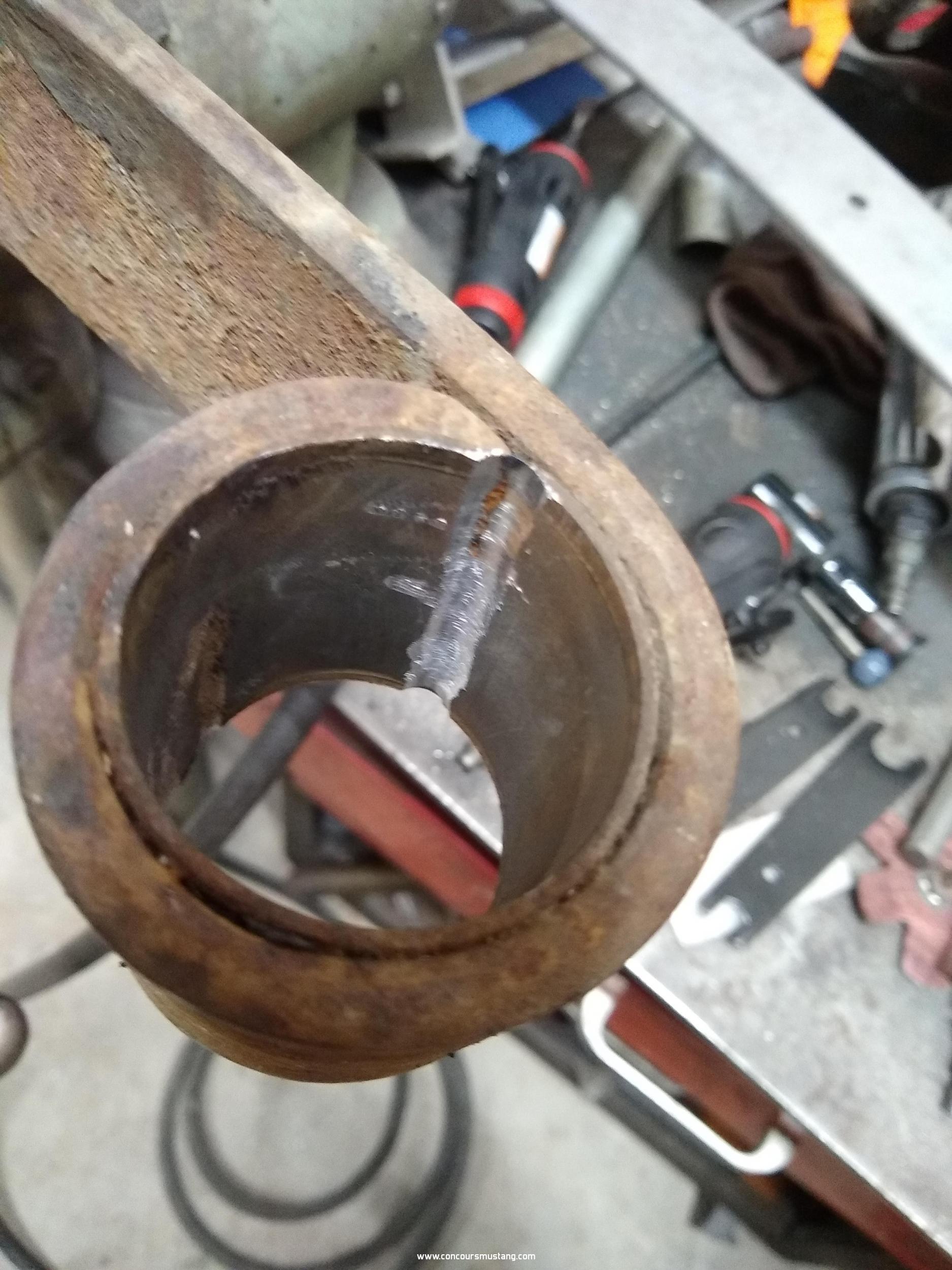

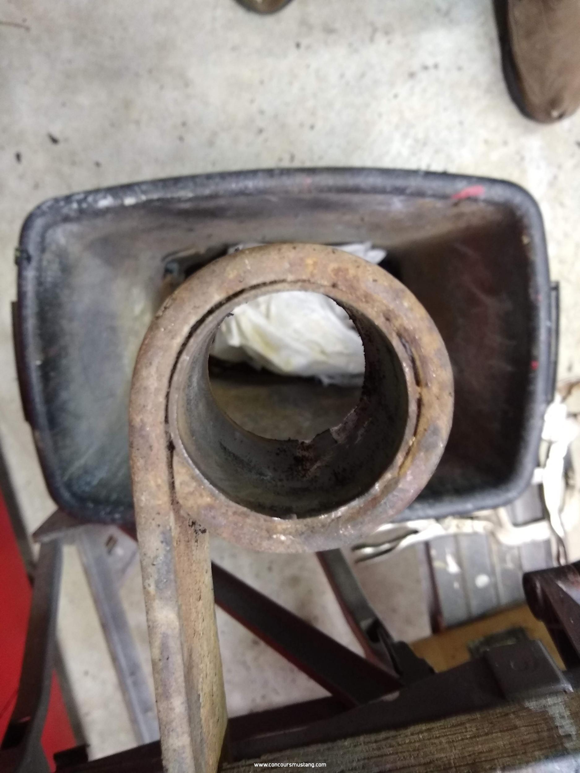

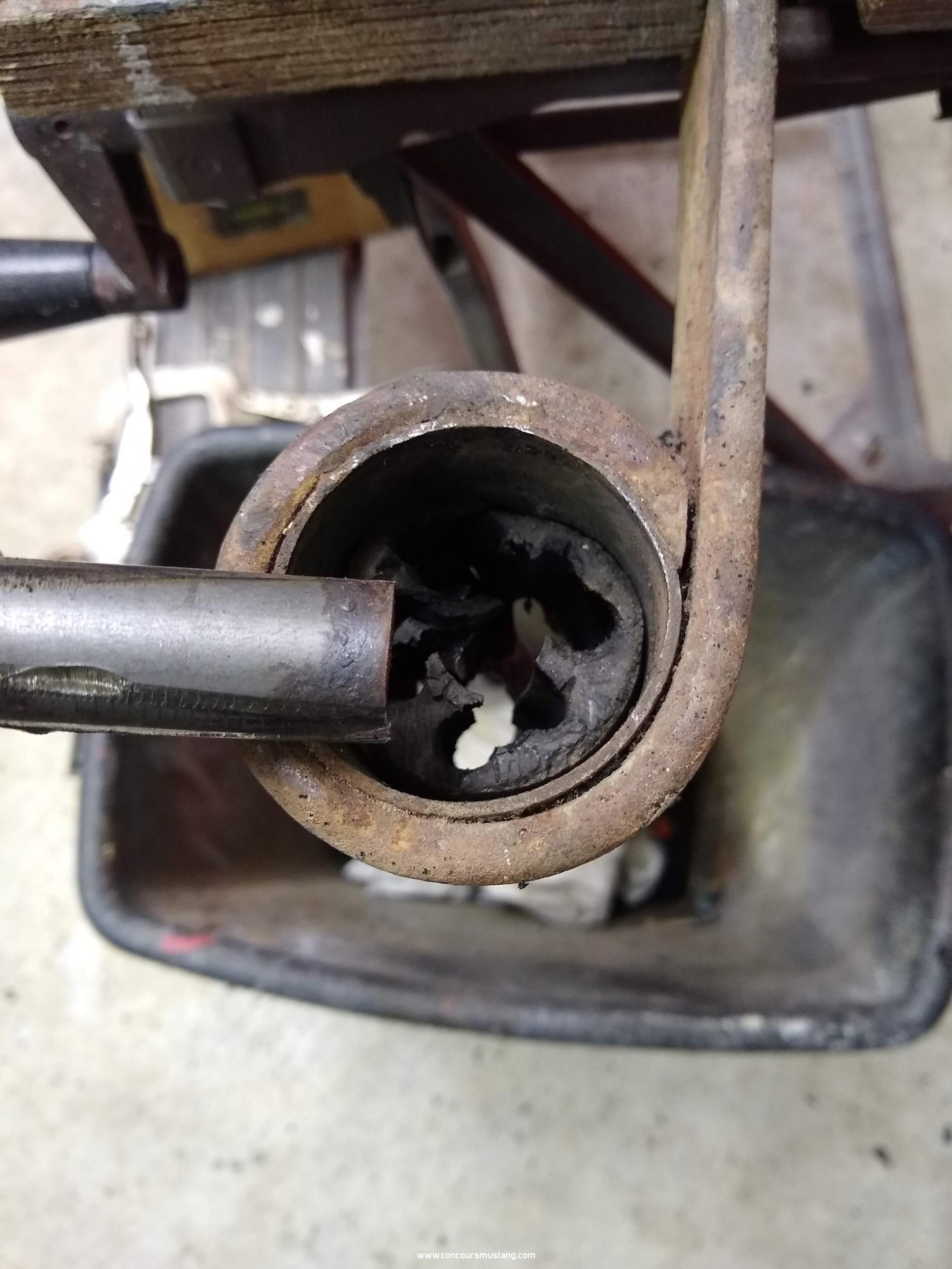

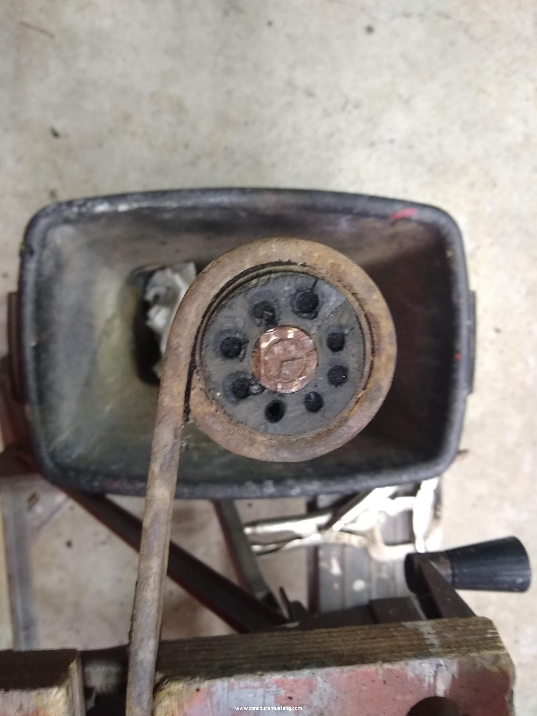

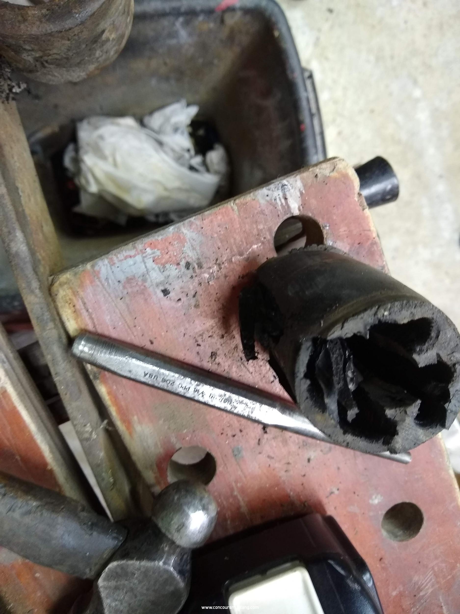

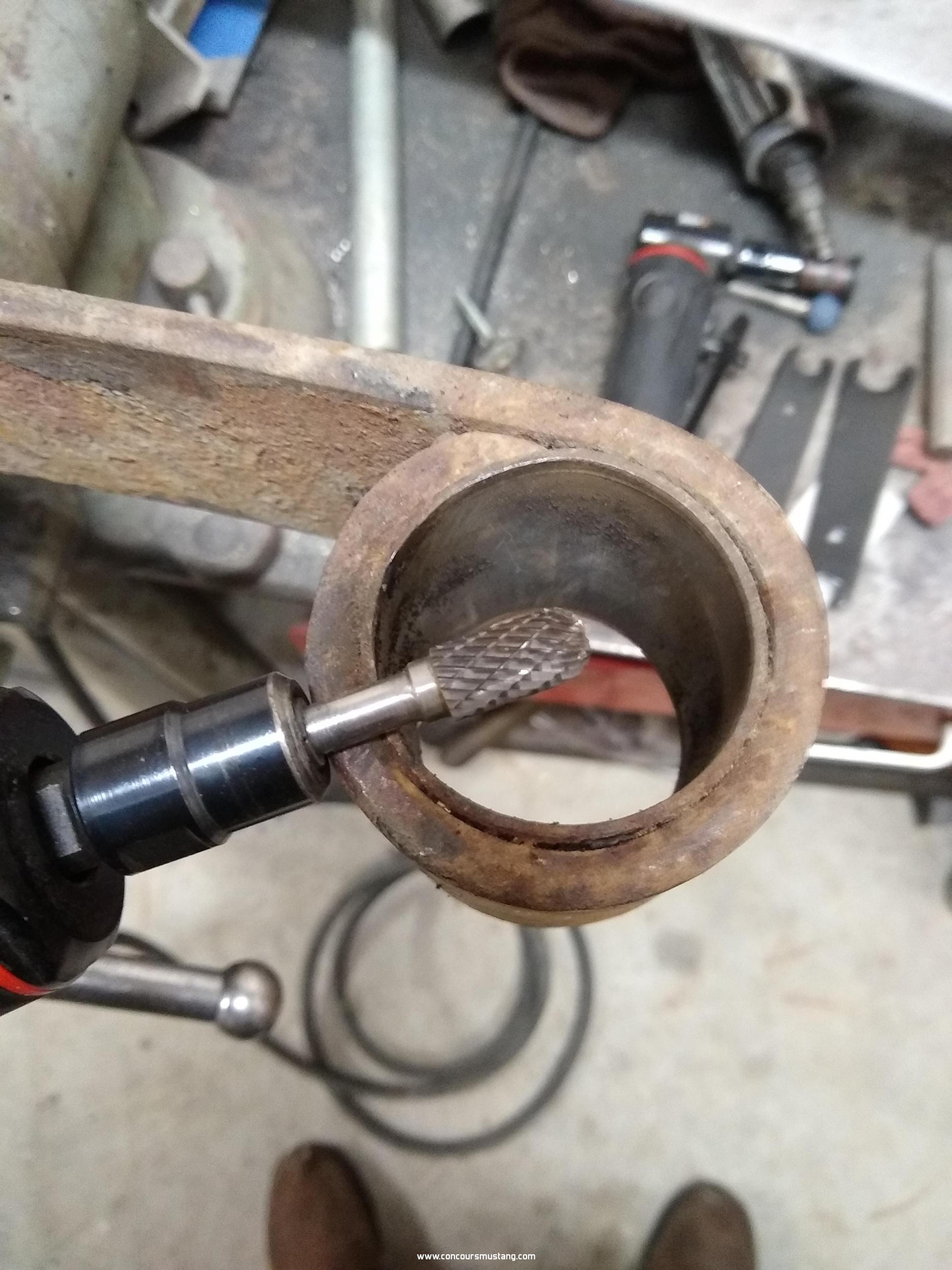

Re: Proper method for installing front eye bushings?
« Reply #12 on: June 08, 2019, 12:06:23 AM »

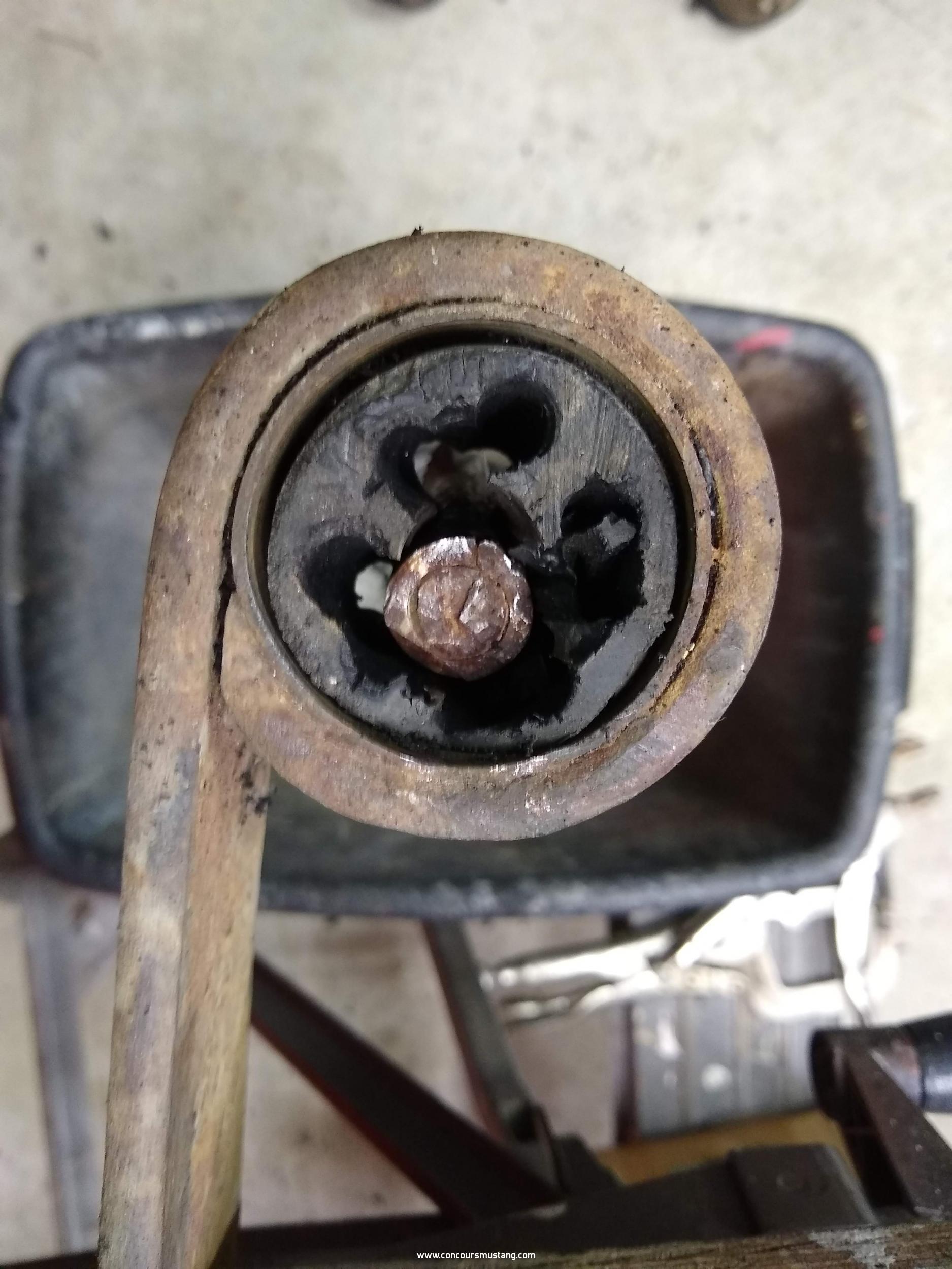

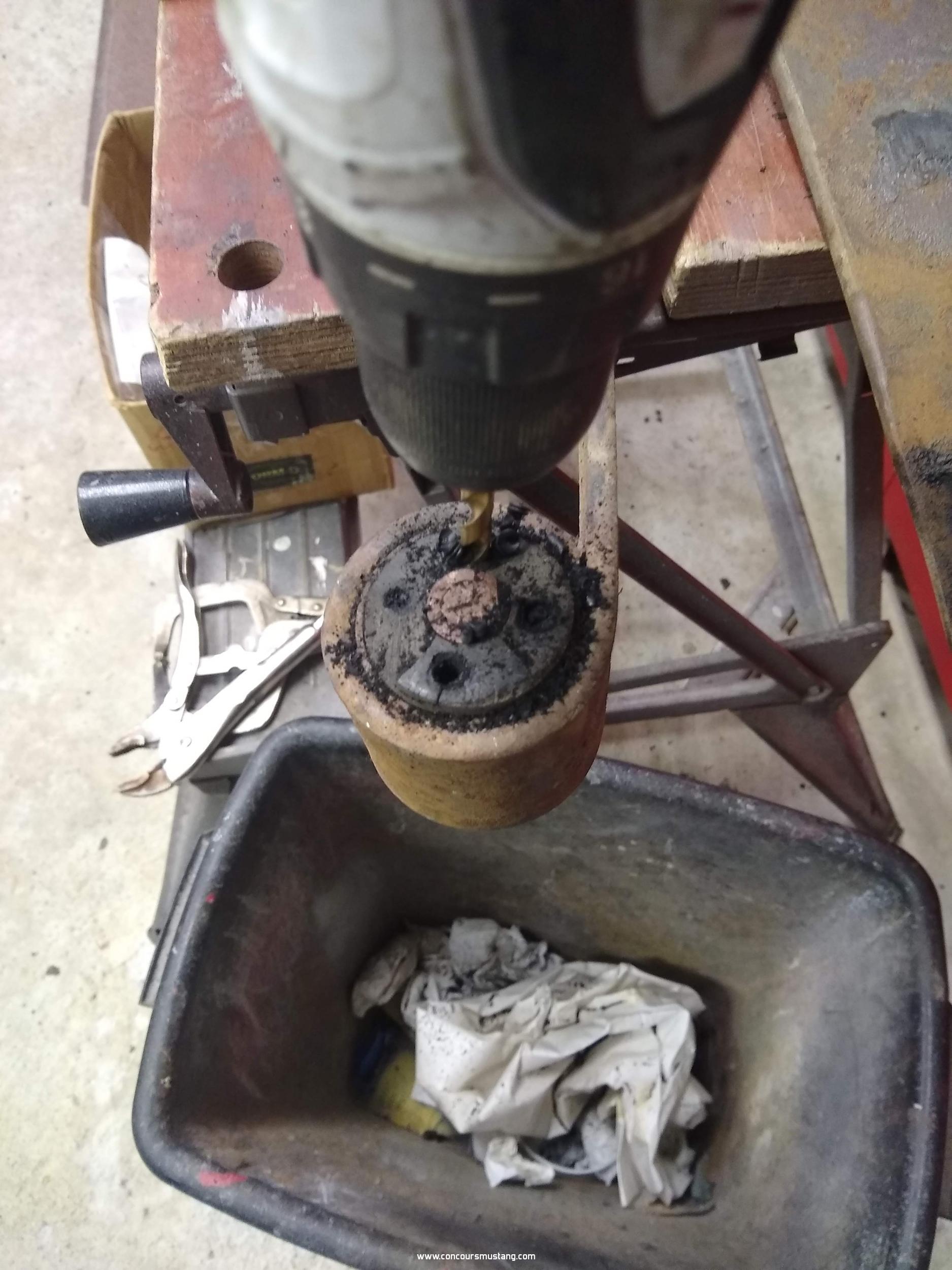

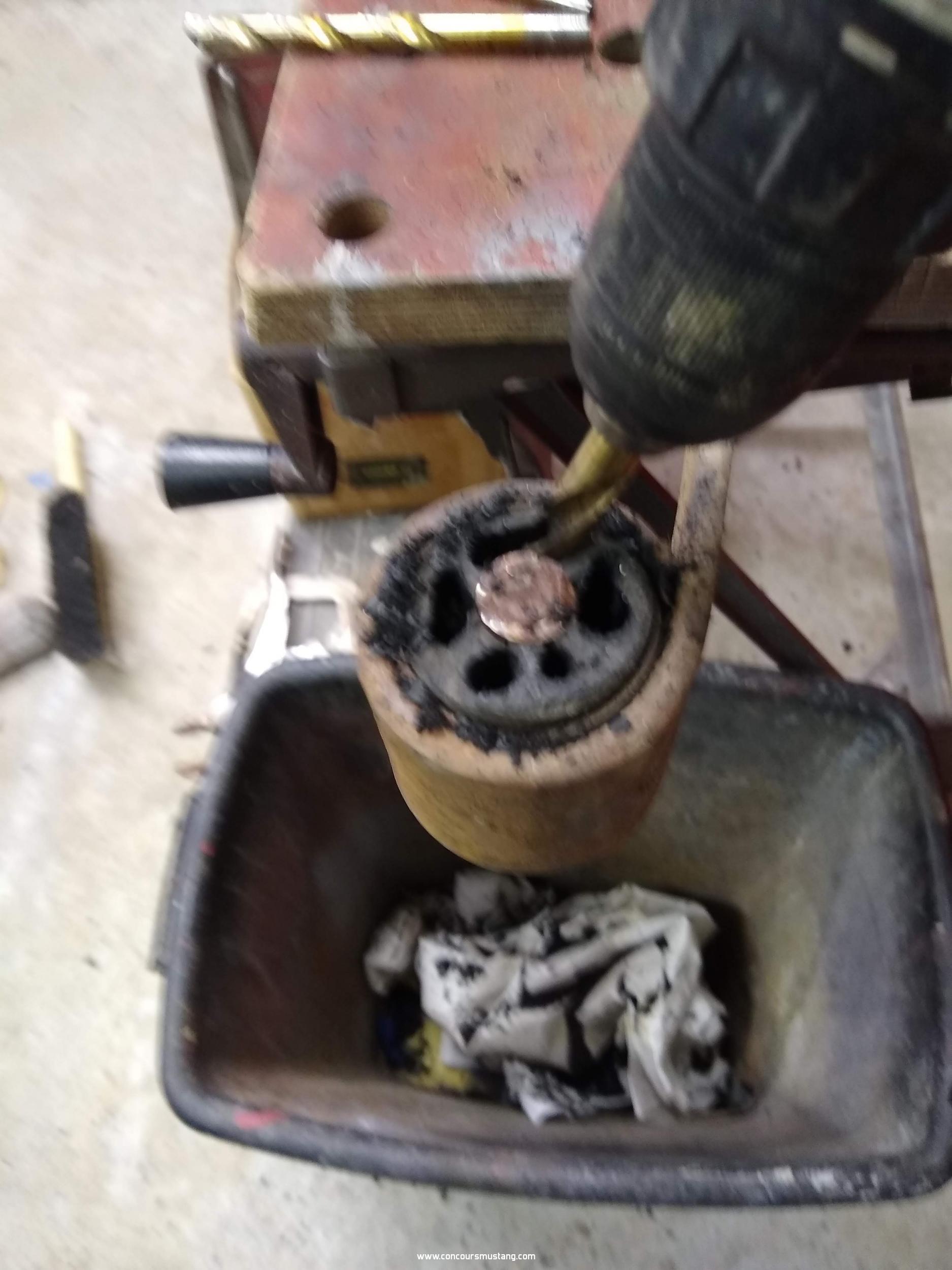

It really does take two people to handle this in a press.
However, this bushing is really rusted in there and I remember the easy, few tools method. This took about half an hour and a lot of that time was taken up taking pictures.
Pic 1:
Drill 4 holes in the rubber bushing. I started relatively small and worked my way up in three steps.
Pic 2:
Drill 4 more in between.
Pic 3:
Drill out the holes with a bigger bit.
Pic 4:
Drill sideways a little, hogging out the holes at an angle.
Pic 5:
By the time you hog out each of the holes at an angle the center bolt is ready to fall out.
Pic 6:
Yep.
Pic 7:
And then the rubber usually just falls out.
Pic 8:
Empty shell.
Pic 9:
Burr in a die grinder
Pic 10:
Grind near where the spring returns back to itself.
Pic 11:
Since the shell is very thin at the grind line it takes little effort to carefully break the shell so it folds back into itself and drops out.
