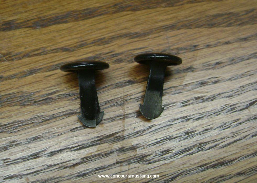

All,
I have lost my power steering hose strap pins for my 67.  Looking for 2 as shown in attached picture.

John,
The picture is way to small to see any detail.

I pulled it from this thread.  Several pictures of installed ones and the one picture Marty posted off them removed.
http://www.concoursmustang.com/forum/index.php?topic=14382.msg89474#msg89474
I will see if I can find another/bigger picture.
Thanks for letting me know it was to small of a picture.

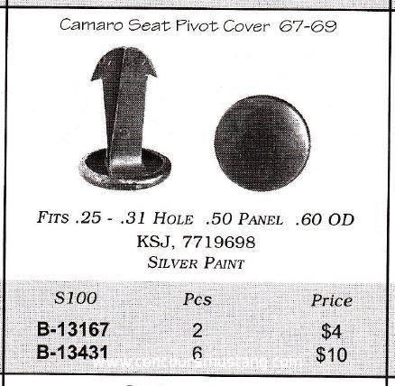

« Reply #3 on: August 18, 2019, 10:47:44 AM »
AMK has one that looks correct, B-13167. Page 159 catalogue 2014. Described as Camero Seat Piviot Cover 67-69
Larger picture from previous post:

The retaining pin is Ford part number C7OZ-3C523-A (see attached). I could find no other reference in Ford Car Parts (MPC) including the illustrations, the hoses end just after the steering ram with a notation of "to the pump". It is shown in the 67 Mustang Chassis Assembly Manual (AM0020) as a blurred mess on page 49, view "V" (LH side, center), but with a bit more clarity in the 68 Mustang Chassis Manual (AM0024) page 70, view "V". However, the base part number in the 68 manual is incorrect, 6E523 should be 3E523. The strap is shown as 3C696 but does not appear in the 60-68 or 75 editions of the MPC.
In other words, Ford documentation is lax.

Thank you Chris and Jim for your help.  I will purchase a pair from AMK.  I had looked there, but not under the Camaro section.  🤭
