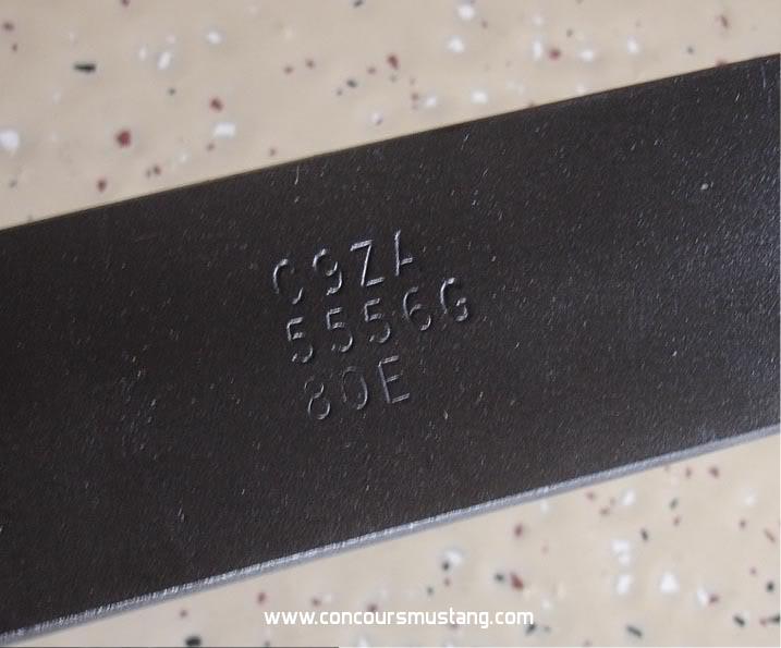

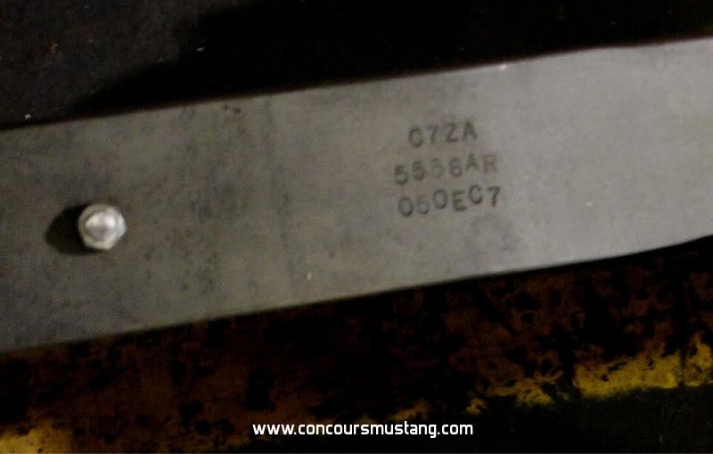

I found another set of local leaf springs. They have a different code/stamp, not sure if I am decoding the date correctly, but it looks like the Oct 27 and my car was built the 23rd week. I am not sure what AR stands for, or which plant is OE7. So far these new springs appear to be in better shape than the previous set of leafs I got from the same seller. I will hav a better idea once I strip the paint.
The other set I have are Nov 26, same plant AS
« Last Edit: February 03, 2020, 03:43:45 AM by bullitt68 »
AR marked springs are for competition suspension. They are highly sort after.
Really? Very interesting. What car would have received those springs. Would they have a different spring rating than the AS for example.
