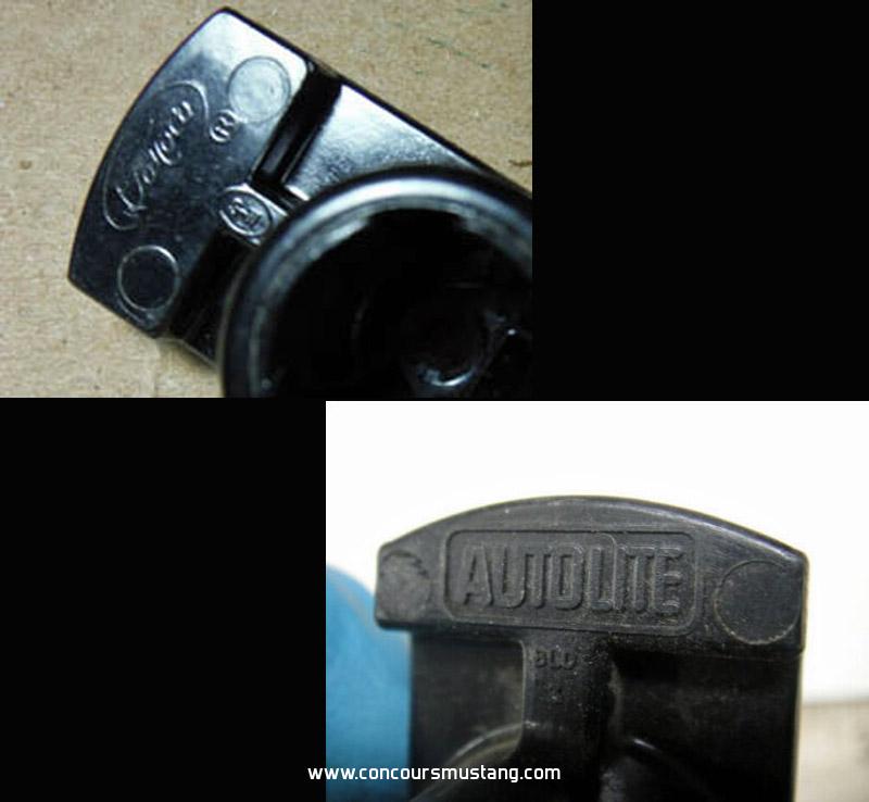

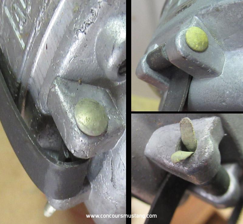

Another close-up of the retaining clip that was posted before in another thread
On the FoMoCo verses AUTOLITE issue as far as how each (rotor & points) would be marked on a 67 I think its going to be a challenge determining when a change may have taken place during the production year. Old stock was likely used up on some lines (at the plant that assembled distributors) and stations while others received the new stock earlier. Guess we could look at and post assembly dates from original distributors and what was in them but as mentioned, the guy in the next bench may have had the earlier or later versions he was supplied with on that same day.
At this point I think you have the option of having either or even a mix unless someone has some solid documention or findings I'm not aware of.
Understand that your likely asking because you want to have the assembly as correct as possible since other than you will know for sure once its all together
Rotors

We've discussed this in other threads but you may find that painting with a translucent paint in two sets get you the closest. The color on original dist in boxes I've got is a gold with a tint of green similar to finishes found on later PVS and Thermactor hose "t"s
I've used Eastwood dichromate rattle cans in gold and green for this purpose followed with protectant oil or a clear coat. Original finish was a plating and provided a very very thin layer of protection so don't cake on the paint or someone will take notice

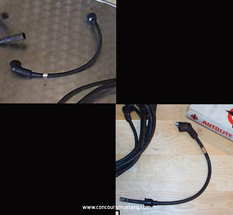

Coil wire is made from the same product/wire used to make the spark plug wire set with a 90 degree boot on one end and a straight boot on the other.

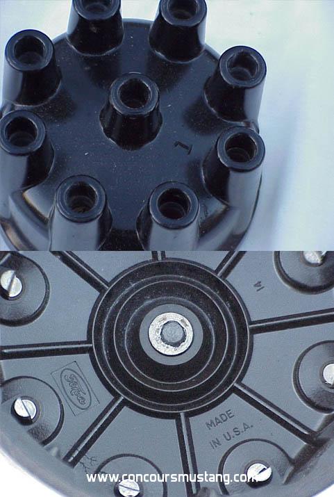

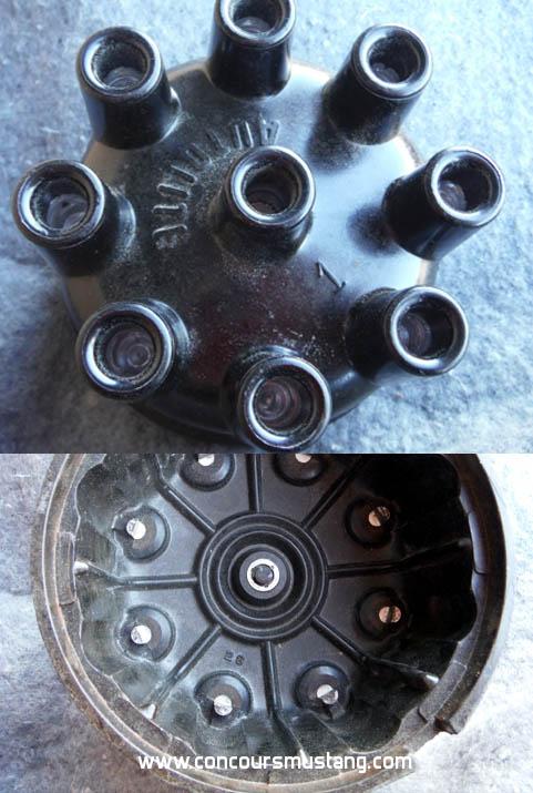

Couple of pictures of both variations of caps from other threads
