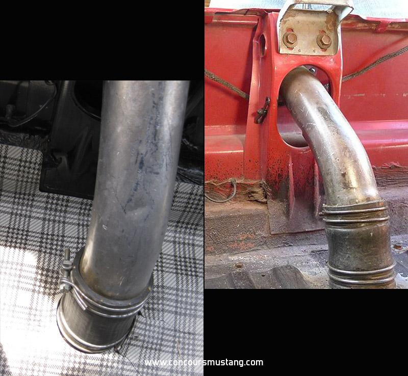

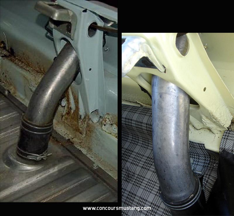

« Reply #5 on: January 04, 2022, 01:06:10 AM »
Ok, I just wanted to be sure it should all line up centered. I have never worked on 65/66 cars before.  This car has been banged up a bit here and there. I don't see signs of any thing moving more than an inch or two.
I suspect the issue is at the gas tank.
Yes not leeway on a 65-66 and the support bracket is shallow
Hope these will help in some way with your issues. Not easy to find a straight on picture
