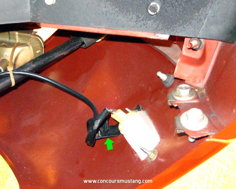

Just thought we should clarify and identify the wire retainer I believe we are discussing in this thread
Dearborn not a San Jose unrestored car

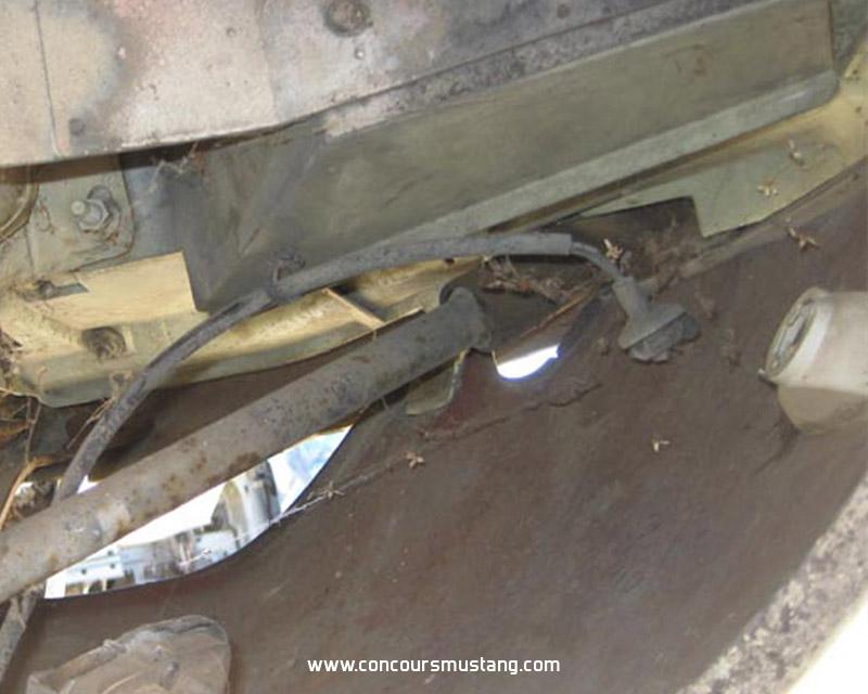

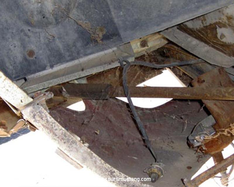

Only found a couple of cars where I still had the fenders installed on the car and pictures of that area. Not wire retainer/clip at marker
9R131xxx Approx first part of Nov 68
9R175xxx Approx first part of May 69
« Last Edit: February 23, 2022, 12:19:37 AM by J_Speegle »

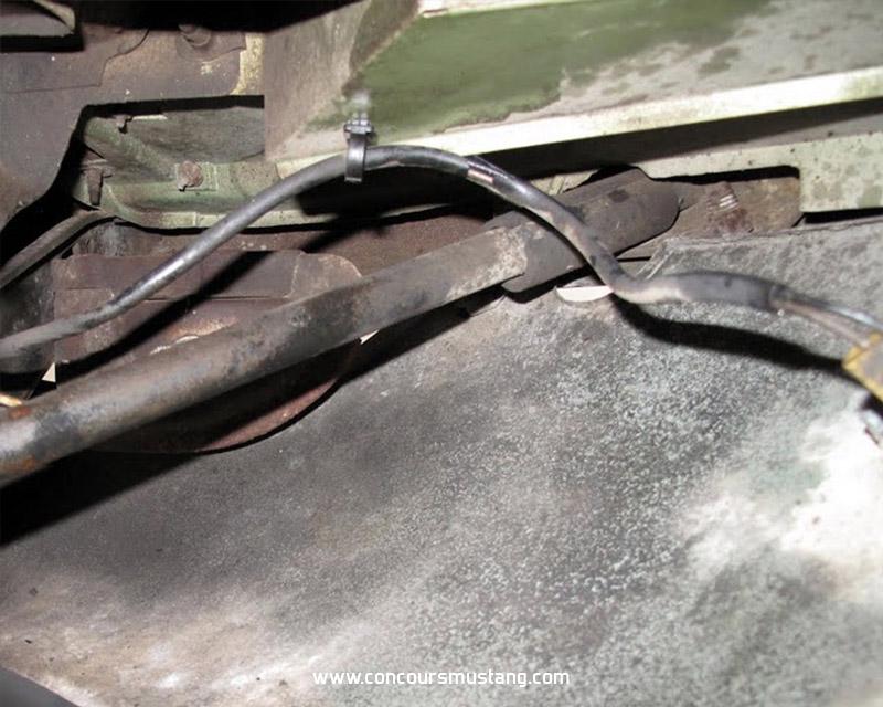

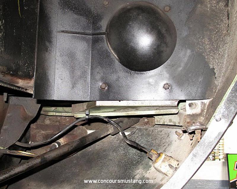

Pictures of my previously unrestored San Jose Jan 69 build
Re: April 69 San Jose Front Fender Marker Light Wire Routing and Clip
« Reply #12 on: February 23, 2022, 05:09:08 AM »
Sure seems like a pattern
Yes those are the clips Jeff.
9R02M123247 was my car that had them but no zip ties so perhaps they were substituted as a quick and easy alternative to the clips.
