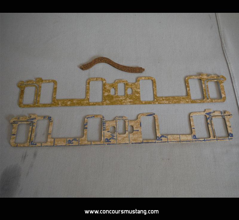

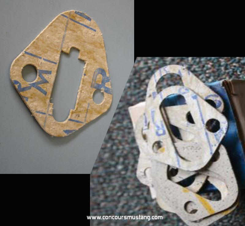

These two I believe came from the same two or three suppliers and from the same material. Don't see any indication that they had asbestos in them and have not heard of anyone testing them in the past. Both have an ink print pattern in one of a couple of colors identifying the supplier. Both applications had a dry spray adhesive on one side of the gasket material. Have not see anything in the engine assembly instructions as to which side to face the adhesive side towards when putting them on an engine. Pictures are from prior postings
Intake Gaskets
   - References were made to white and that's all I have
Fuel pump gasket
     - White asbestos

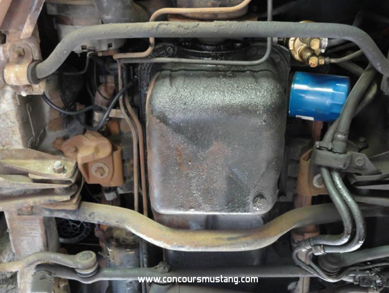

From a 66 GT unrestored car taken from underneath, I see a drooping square pan gasket near the fuel pump.
https://www.concoursmustang.com/forum/index.php?topic=16692.msg104399#msg104399
Caveat 1: unknown if engine is unmolested.
Caveat 2: Unknown if 66 and 67 used the same pan gasket.

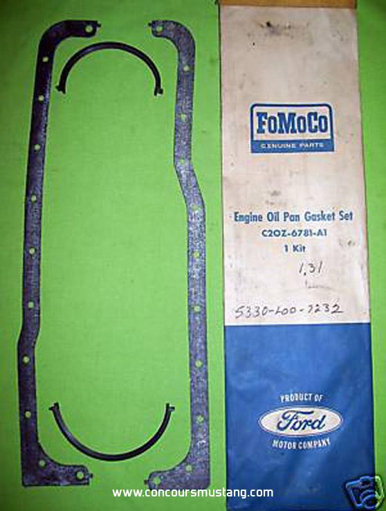

Found a couple of pictures with a little deeper look. An individual oil pan gasket set from the 60's and a engine gasket kit with the oil pan gasket. Don't know if there is another kit with the timing cover and thermostat housing gasket or if someone just used those from the kit and this is what is left. Guess I could look it up in an old MPC to check and compare.
Also have a picture of a box with 10 sets of oil pan gaskets from the 60's though the box is not open to show its details and contents

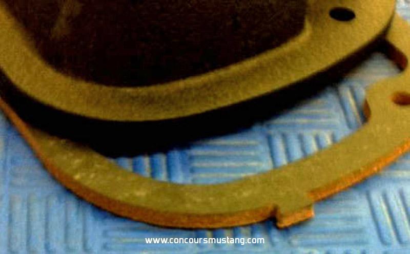

Also, what color is the thermostat gasket on the 67 Shelby GT350?
On other 289s it is painted with the engine so the color is immaterial. On the Shelby I'm assuming a new one had to be sourced during the intake swap.
In my observations they were a dark tan color  like many of the replacements of the time but different since they had to round bolt holes in the gasket no one hole and one slot

The pan and valve cover appear to have the black paint/sealant on the surface. The edges would be bare cork. It appears that the early cars could have black gaskets and later cars just cork.
The head gasket is interesting -- I see the hole!
Dark tan for thermostat gasket is also not quite what I thought. This would certainly be seen between the blue housing and an aluminum intake on the Shelby.

Take notice that the one oil pan gasket has a rounder corner  that the other. On original engines its been my observation that "squarer" of the two was installed on the drivers side
As for the black I'm uncertain if the engine assembly line cork gasket were painted black originally and IMHO its very possible that service replacements were painted black to keep them from drying out from sitting on a shelf somewhere for years.  Positive thing is that for 67 Shelby the oil pan gasket got engine paint

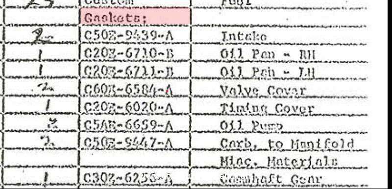

« Reply #14 on: August 10, 2022, 06:27:39 PM »
To go along with the posy above about the two different long cork oil pan gaskets I found this mentioned as I was searching for info on the valve cover gasket discussion. The list of parts used for a 67 Shelby race build identified C2OZ-6710-B as for the RH and C2OZ-6711-B as the original gasket for the LH. Should provide you with additional gasket part number for your other questions/threads So I will repost there
