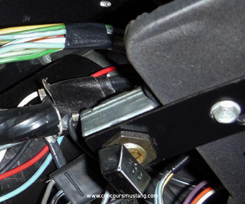

Here is a close up from an unrestored 67 San Jose Mustang with a VIN just over 7R200xxx
Can't make out the head markings fully looks like it possibly is the one marked CF on the head like the one in your picture. On a GT Mustang the screw also secured the bracket the grill light switch was mounted in also as shown in the picture. Got lucky and had this picture.
CF is one of a couple typical head markings I have seen used there.

« Reply #7 on: August 17, 2023, 11:18:11 AM »
The bracket is typically unpainted bare steel when I have observed it.

« Reply #13 on: August 19, 2023, 11:11:22 PM »
Did get a chance to look at a few unrestored 67 San Jose examples in the last few days and since this subject came up I did look at this details while I was looking over the cars. Each had the same hex headed screw with the CF markings on the head.  As an aside and since Jim brought it up I also have a collection of hardware just about 90% from San Jose built cars and have a fair number of CF marked hex headed screws but I can't report, without going through buckets their exact length or size.
