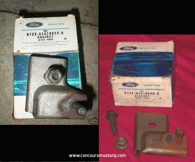

Hi All,
Can anyone guide me or is there any video on replacing this drivers seat hinge>
D7ZZ-69618C46A
Many Thanks

So your doing this on a 70?  Guess it will work but originally the recall and part were made to address the 1968 and 1969 Ford and Mercury models but guess it could be adapted to later seats and frames. At least from what I've collected over the years. Since this was a 1977 recall/campaign for a 9 year old car I don't think I've got TSB's from 1977 that would cover this application. Believe that is where your going to need to look to
Here is the other thread on the same topic but titled for 68 since that was the first year of the recall and fix. Found using the words "seat recall" in the search engine. May merge these two threads together
https://www.concoursmustang.com/forum/index.php?topic=20631.msg130301#msg130301
For others - what the kits looked like and the recall/campaign (as Ford like to refer to these things during the era) some information related to that
Just a couple of the 4-6 listings I found when I last checked
Recall Date: MAR 28, 1977
Model Affected: 1968 Ford Mustang
Summary: THE SEAT BACK PIVOT PIN BRACKET ON THE INVOLVED VEHICLES MAY FAIL. CONSEQUENTLY, THE SEAT BACK WILL ROTATE REARWARD.

My Car is a 70. yes
This part was inherited when I purchased the car.
Look its not that bad - on a slight tilt. So do you think this can be done for a 70.
Just no video on how to? that I can find?

it shows how to  replaced the whole seat base however ...it does guide you what do look for..
I guess you have to grind out exisiting weld and place this bracket over and drill a hole to bolt it onto the frame
I  also  found this on the cougars pages however - seems to be missing part of step by step photos sadly  :(
https://www.motortrend.com/how-to/127-0311-ford-seatback-fix/
https://forum.classiccougarcommunity.com/t/1968-cougar-left-bucket-seat-hinge/11549/21

The drawing looks like one typically with a TSB.
Yes you to clamp and drill a hole for the bracket and hopefully don't have any damage to the frame or cause more when removing the original pin. Would be great to find the text that goes with the drawing since that normally includes the steps needed for the process
