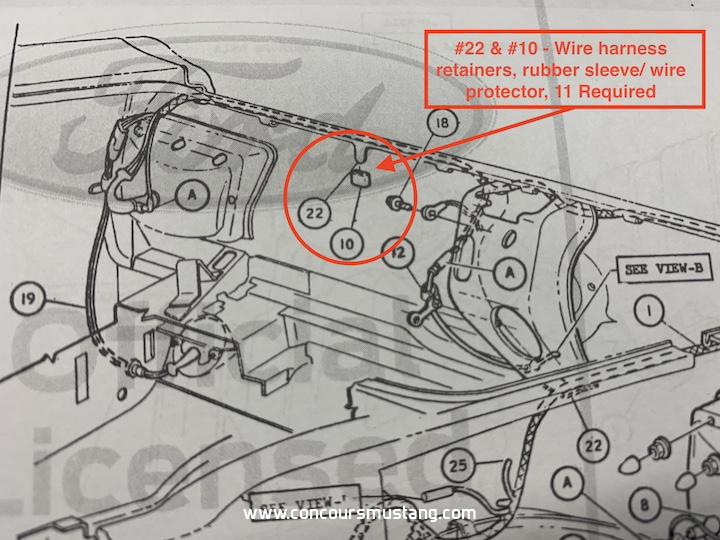

Just curious about these wiring harness retainer tab protector tips. There were none on my car, but the assembly manual indicates that there should be 11 for the trunk. Were they also used on other wiring tabs in the car or just the trunk?

I did not see them anywhere else in the Assembly Manual

Well I counted my tab protectors and I have nine. I am missing the two under the driver side rear fender. I double check the Electrical Assembly manual page and it does say 11 are required so I am assuming those two tabs should have them.
