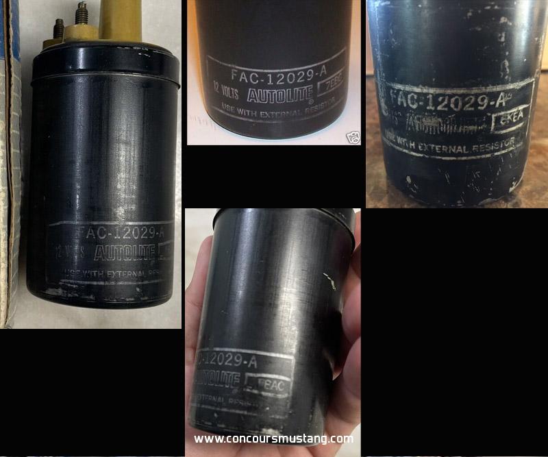

I am looking for pictures of NOS Original or used Original yellow top ignition coil showing the silver ink stamp with any date code. Just looking for the ink stamp position very top or very lower or centre ??

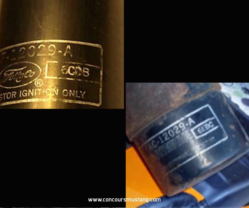

Here's a couple. This is a 1965 coil that was painted black, stamped with silver ink and a black painted bracket attached, you can see the negative on the stamp on the inside of the painted bracket. Also is a dimension drawing for a stamp if you get one made. The last is a representation of date codes for 65 and 66 Mustangs. I don't remember the font size. I think it was 12 point, or the font type, but you can use the information as you see fit.

https://www.concoursmustang.com/forum/index.php?topic=13325.msg81764#msg81764
https://www.concoursmustang.com/forum/index.php?topic=2947.msg15690#msg15690
Just a few of the examples I have pictures of have produced and  provided these for years. Pain to to get stamped on coil either using the roll on or roll over methods. But if you get a wiggle in the print there are a number of examples where originally they had similar wiggles in the stamping. Hope this helps

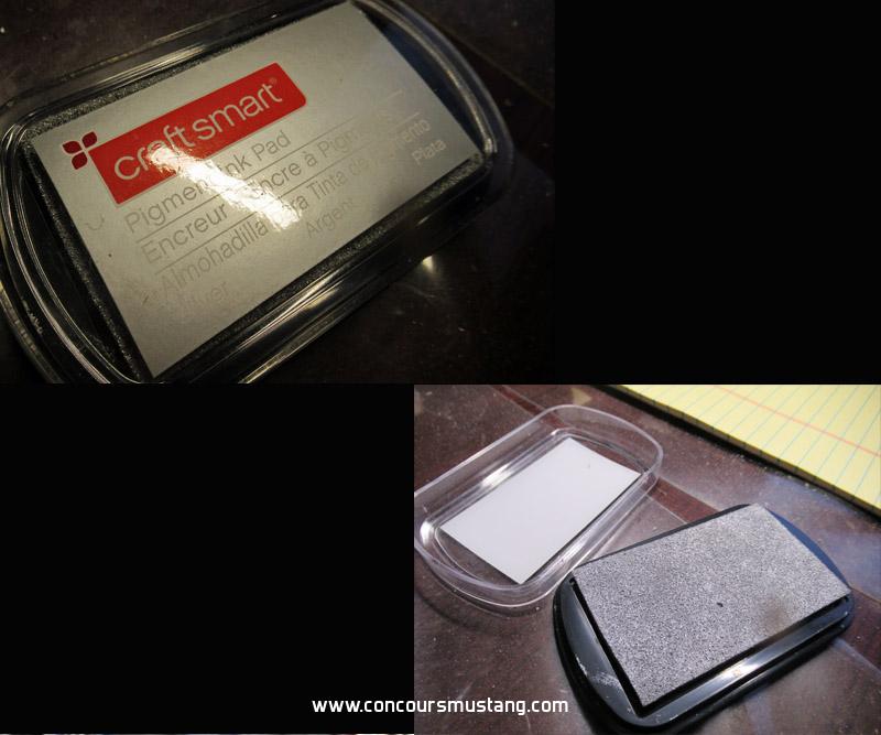

What paint or Ink should I use please?
Re: Looking for Used or or NOS ignition coil ink stamp pictures
« Reply #5 on: January 05, 2024, 06:40:08 PM »
Recently I've been using ink. Paint can get stringy and have more push out it seems but you want a little of that IMHO for the later borders at time
Just from the local craft store
