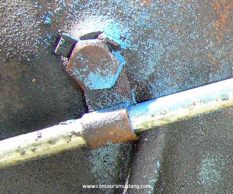

Good Day All,
I am reviving this old Post to make reference to the first picture in Reply #2 by Jeff Speegle.
We are currently doing some detailing on the FMX transmission for my 1969 Shelby GT 350 convertible, #480202, Build date 01/09/1969.
In the picture mentioned above, what I believe to be a vent tube on the passenger side of the transmission is shown. There is a retaining clip for this tube. The one on my transmission is damaged/partially missing. I am looking for a picture of that clip in order to try to find a replacement.
Any help would be appreciation. Thanks for your time.
Tom Gilliam

Re: 70 FMX - Vent Tube Retainer and Details
« Reply #2 on: January 16, 2024, 08:08:34 PM »
Jeff,
I think he may be asking about the clip on the steel vacuum tube for the modulator valve... :)
TOB
« Reply #4 on: January 16, 2024, 09:22:44 PM »
From a 70 FMX but looks to be the same
« Reply #5 on: January 17, 2024, 04:07:28 PM »
TOB,
Thank You for further defining the description of the tube I was referring to - steel vacuum tube for modulator valve. I was not sure what to call that line.
Jeff,
Thanks a million for the picture. That's exactly what I was looking for, the information I needed. I tried to add words to the title when I wrote the reply but it did not show up when I Posted. I guess I did not edit it correctly for posting. Your picture of the passenger side of the FMX transmission in the old Post was the only one I could find but did not do a good job describing what I was looking for.
Thanks guys, much appreciated.
Tom Gilliam
