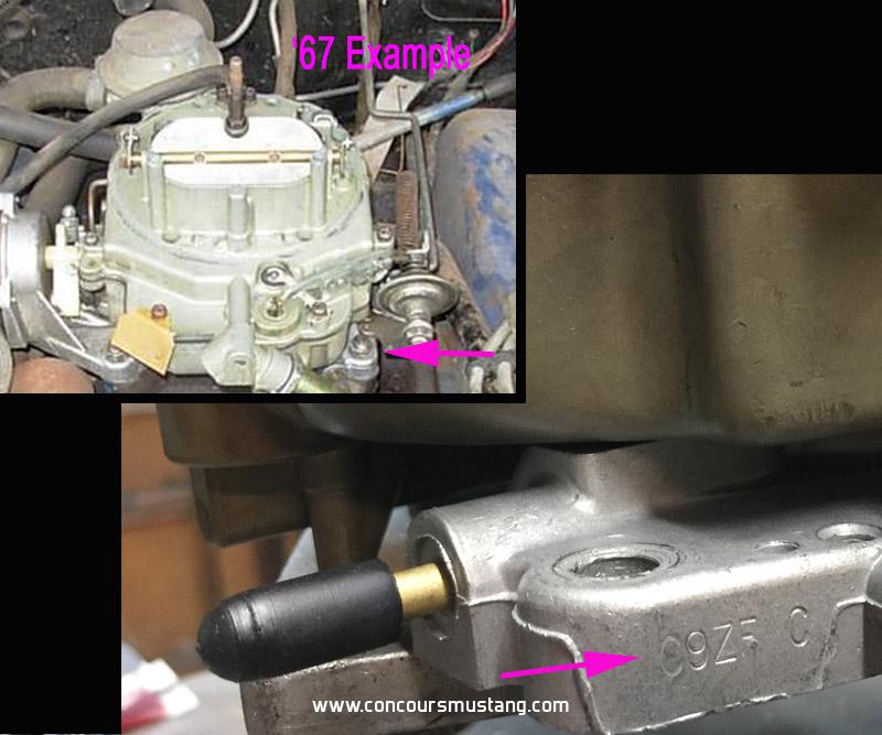

Thought this info was in another thread but could only find non-Thermactor related threads
67 Mustang 4100 Autolite With Thermactor and manual transmission - C7DF-C
67 Mustang 4100 Autolite With Thermactor and automatic transmission -C7DF-D
Don't have a close up of the base of a 1967 4300 but here is an example from a 69 version. Have some NOS C8's out in the garage but these pictures were handier  :)
Notice that the tag on the carburetor is made of bras instead of the regular material. This identifies it as a Thermactor 4300 during  1967 production
