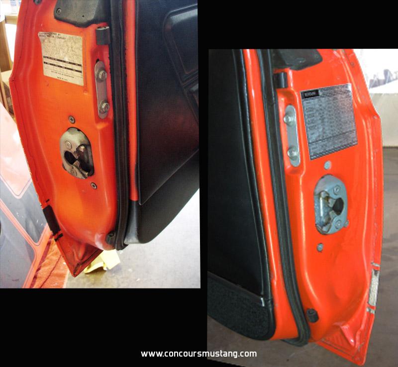

I know this is a very old thread but have one follow up question.
Is the same charcoal metallic used on the bottom of the door as well?
Didn't see it referenced but could have missed that.

  • Posts: 24855
Re: 1970 black interior help please.
« Reply #3 on: July 17, 2022, 02:54:02 PM »
Thanks again for great site and information!
Depends on which interior you have.
If standard interior with the narrow door panels and the removable thin painted top edge panel then yes if its a Mach I, Grande or such with the full sized door panel then no
This goes for all colors
Will try and post some pictures is a while
  • Posts: 24855
« Reply #4 on: July 17, 2022, 09:02:12 PM »
As promised an example of each. On the ones with painted lower surface the interior paint was applied first, then masked of before the exterior color was applied. The interior paint does not go all the way to the weather strip retainer and how it was masked will differ between plants so would have to know your cars details before we could offer any details on that
« Last Edit: July 17, 2022, 09:07:04 PM by J_Speegle »

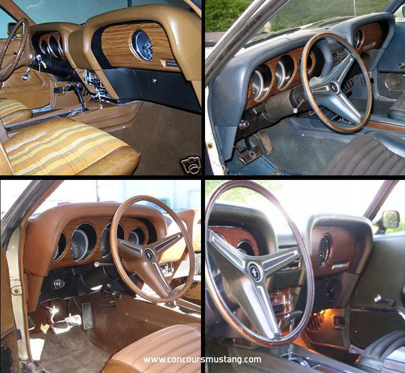

Offline BHStang
  • Posts: 88
« Reply #6 on: August 04, 2022, 12:57:44 PM »
The dash pad extensions (four triangle panels below the tips of the dash pad) are shot with the same color only slightly flatter
Some prior posts the Search feature returned
Jeff are we sure these plastic dash parts were painted same as the metal dash frame?  Or maybe only on black interior cars?  My June of 70 DAP Mach 1 had a Green interior and those 4 plastic triangles were green molded plastic.  My understanding is those plastic pieces are to simulate extension of the dash pad over the dash frame and thus should match dash pad in color as they did on my Mach 1.

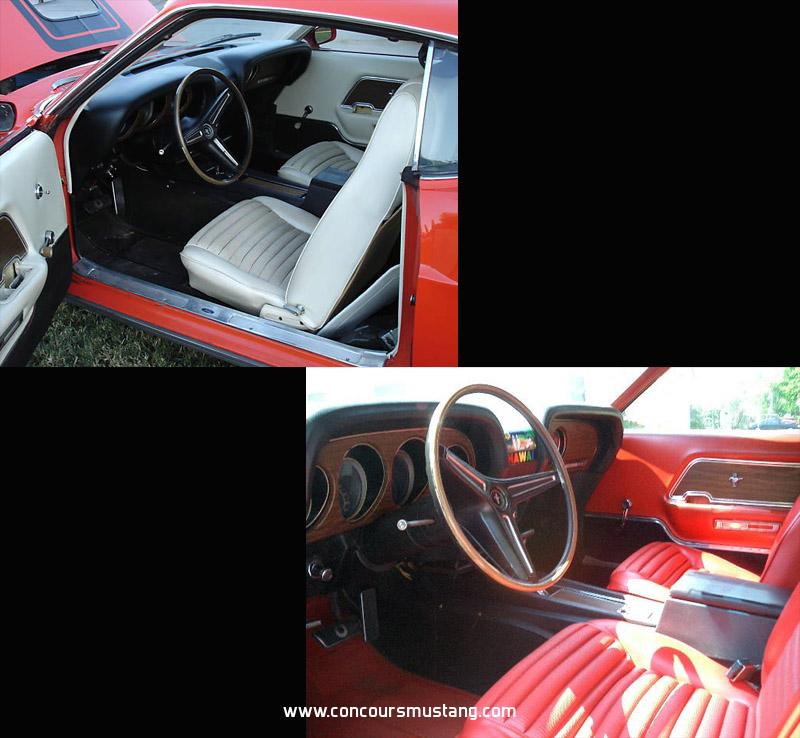

  • Posts: 24855
« Reply #7 on: August 04, 2022, 04:25:02 PM »
The thread is focused on "black" (Dark Charcoal Metalic) interiors  for 1970 the four extensions sort of match the dash pad color on Mustangs They were sprayed a flatter finish for some reasons
Allot of other colored interiors also used black dash pads so the finish of the dash painted parts are the same as the "black " interior ones. Examples, whit and red interiors
So they are green, front and back and if you cut through them, drill a hole in them or deeply scratch them the material is still green?
Agreed as shown below on original cars
Offline BHStang
  • Posts: 88
« Reply #8 on: August 06, 2022, 09:04:02 PM »
Im looking through the old parts to see if I still have it.  I remember looking close it was green both sides and sure seemed like molded color.  I have seen a few colored originals for sale too and they are also colored both sides.  Painted or not through the point for clarity is that they were color keyed to the dash pad and not charcoal.

  • Posts: 24855
« Reply #9 on: August 06, 2022, 11:57:29 PM »
Agreed. The color of the extensions depended on what color the interior code was. Could be charcoal or dash pad color. Here are two interior options were the interior code was not "Black" but the extensions were black/charcoal. In these the extensions matched the dash pad
