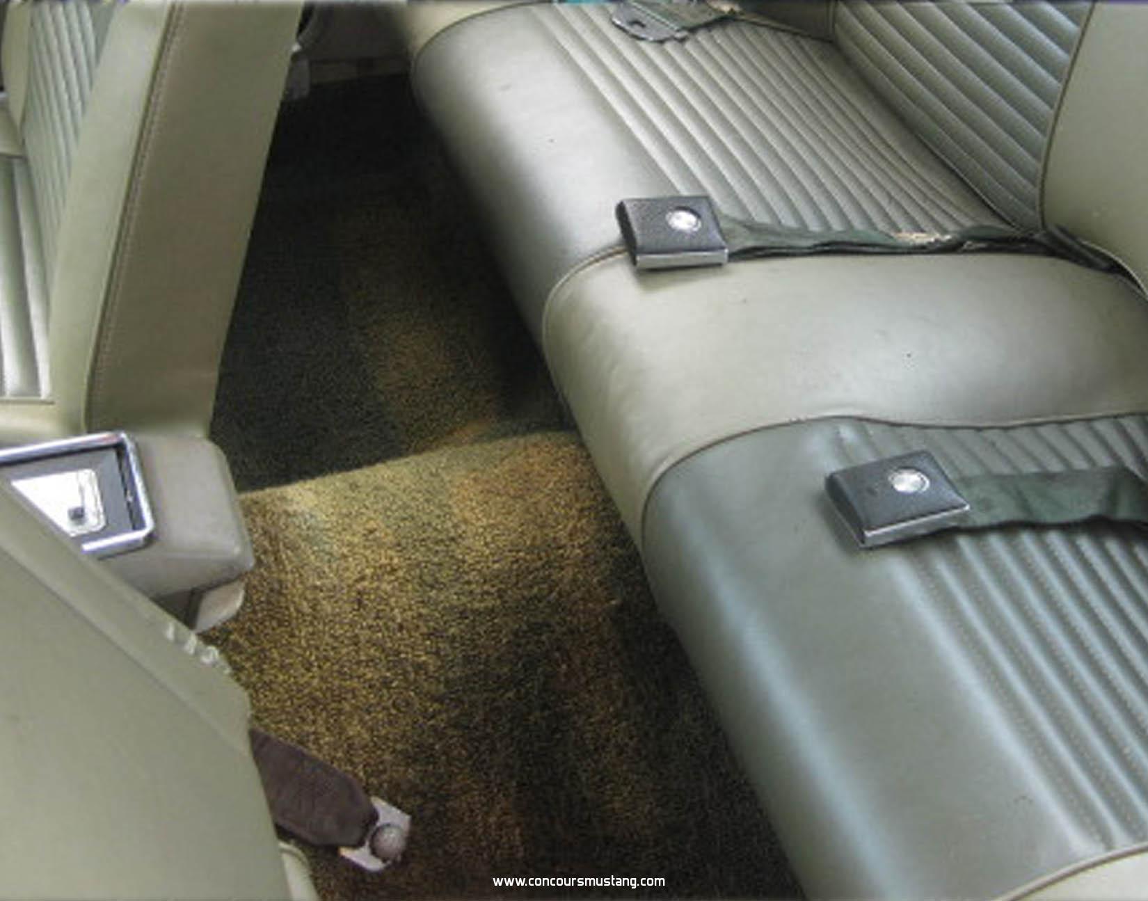

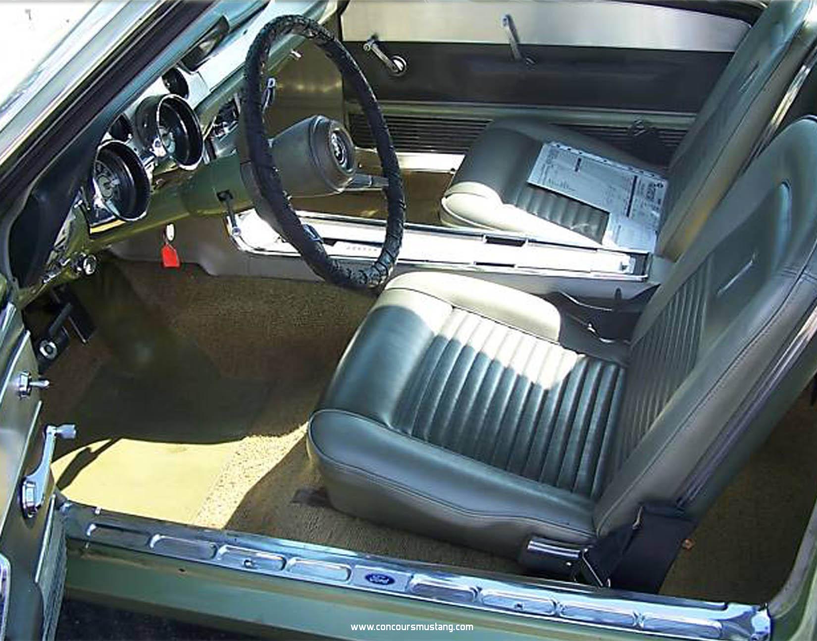

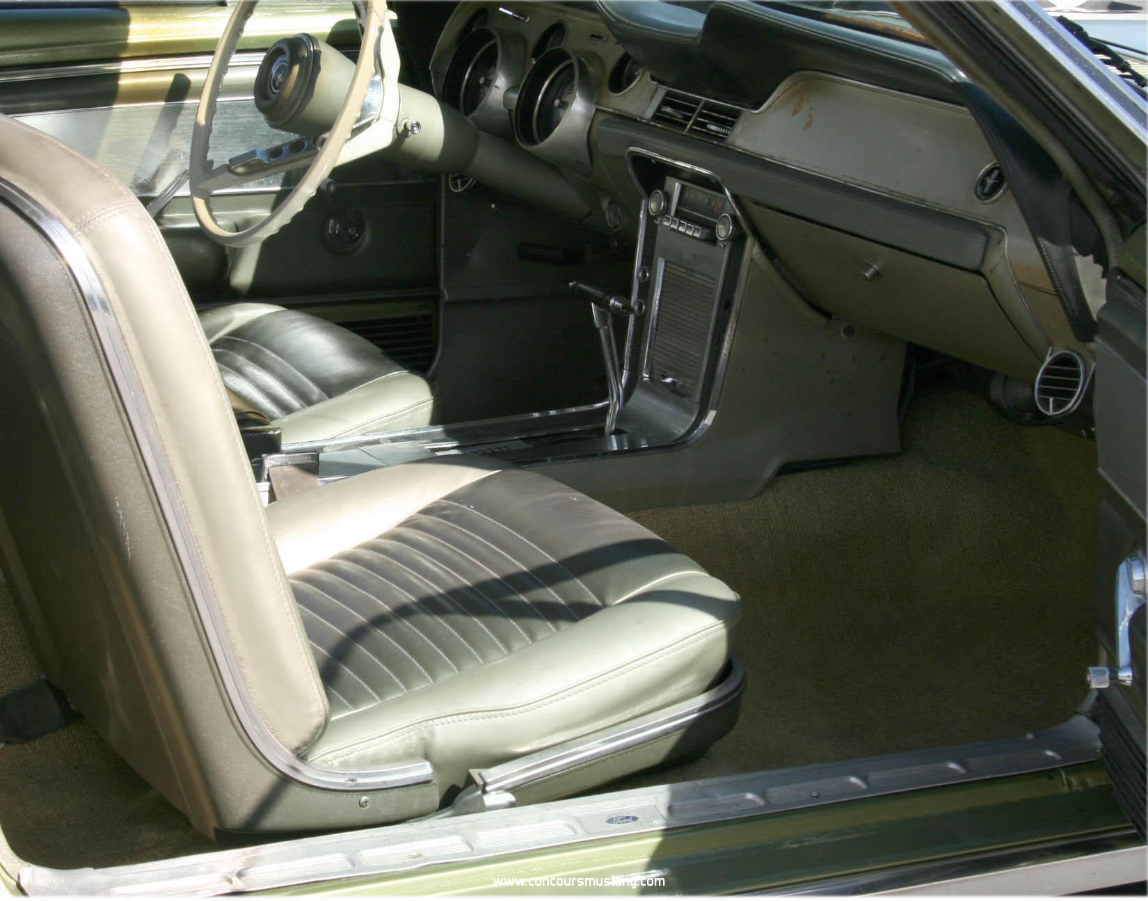

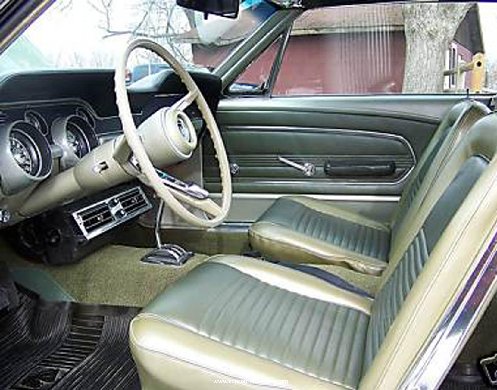

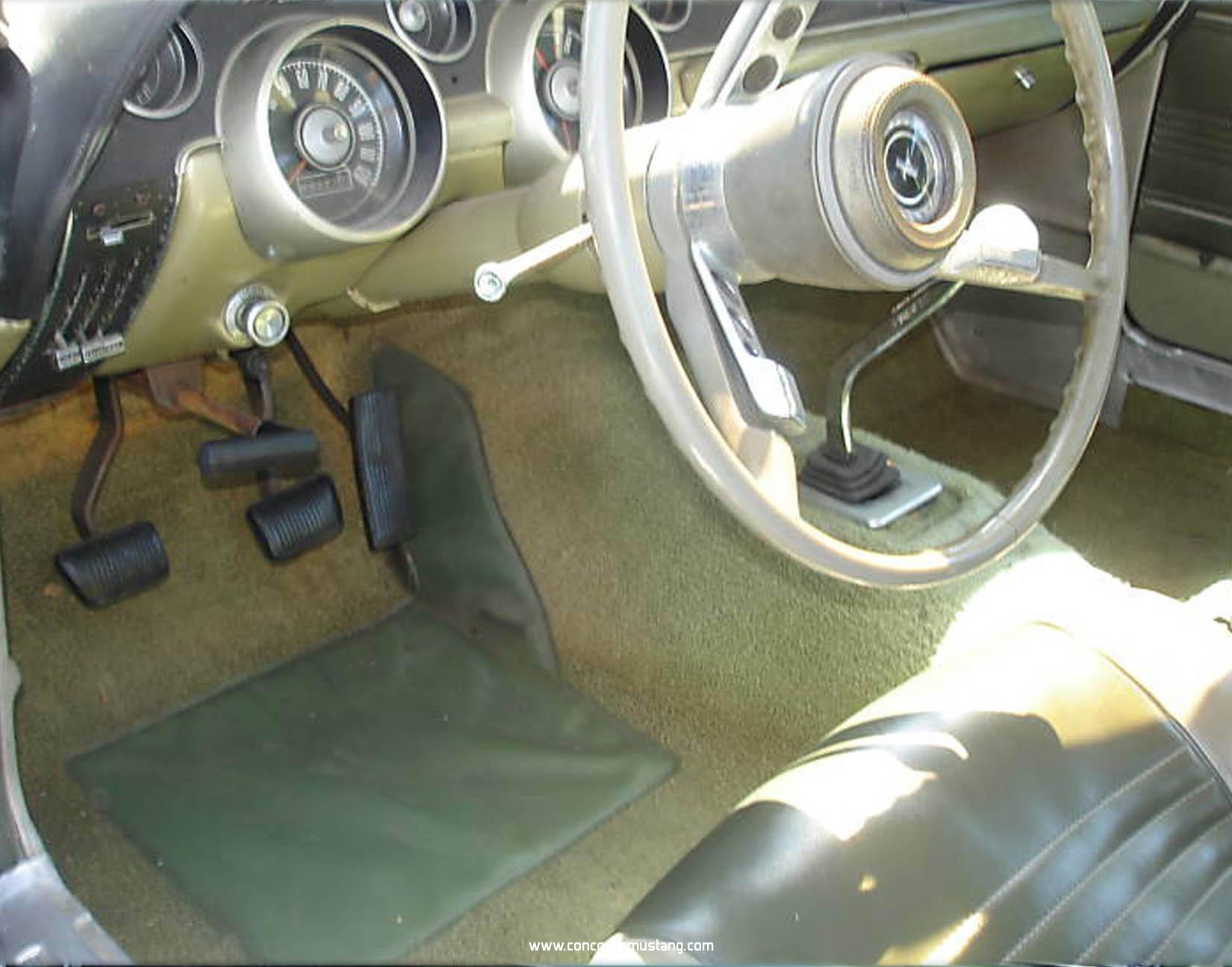

Short answer - no doesn't look like it.
Looked through allot of pictures to find what appears to be the original carpet cars ( carpet was one of the first things replaced it seems)
Plenty of replacements with darker color - odd colored heel and toe pads. Even one green interior with what looked like blue carpet
I offer the following examples ;)

Re: Correct Carpet for '67 Ivy Gold Interior
« Reply #5 on: May 02, 2017, 05:51:20 PM »
Jeff,  this light green color carpet would  be used with a 4G ivy gold, would it also be used with 6G dark ivy gold ?
The pictures I posted above are a mix of green interiors and its difficult (as well as assumed that many have been changed) to tell sometimes if they have been replaced. But since the selection of green carpet over the years have been limited sometimes the replacements really stand out.
Will post some more though it may confuse things as much as clarify.  Tone/tint may even relate to timer period and plant/supplier for that specific plant.
