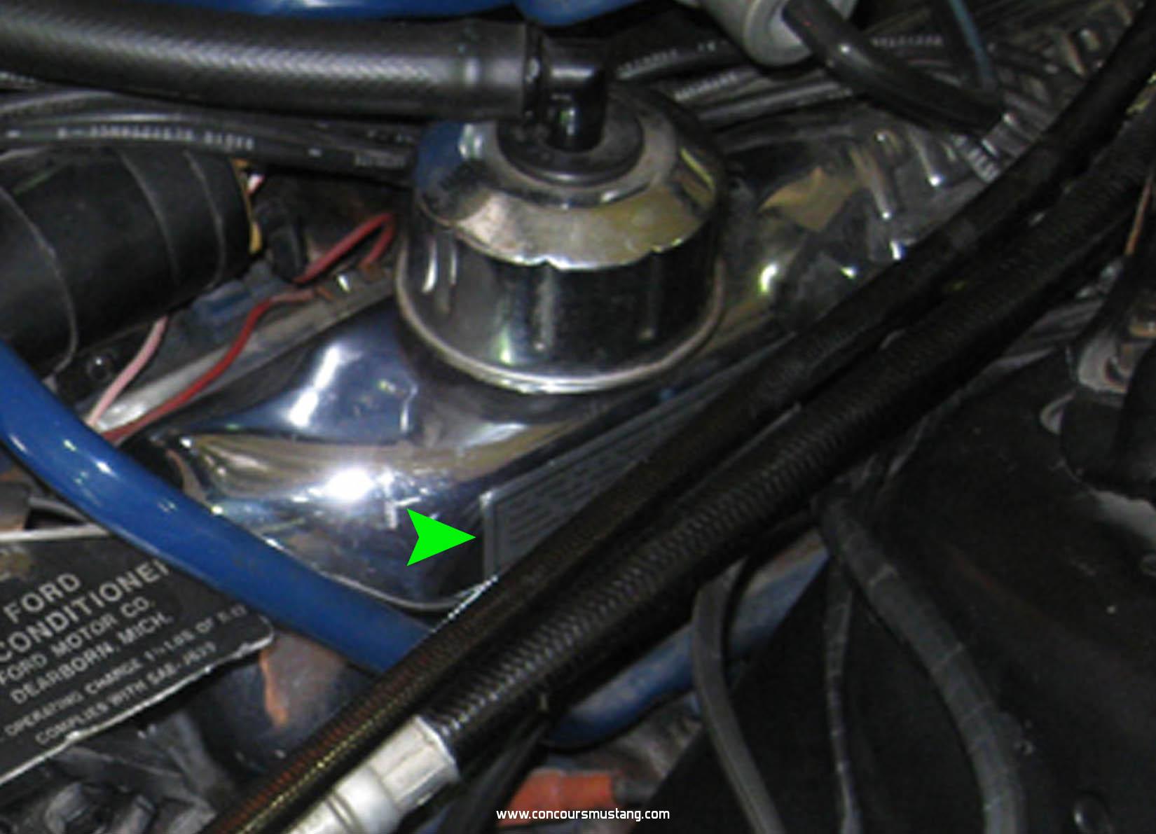

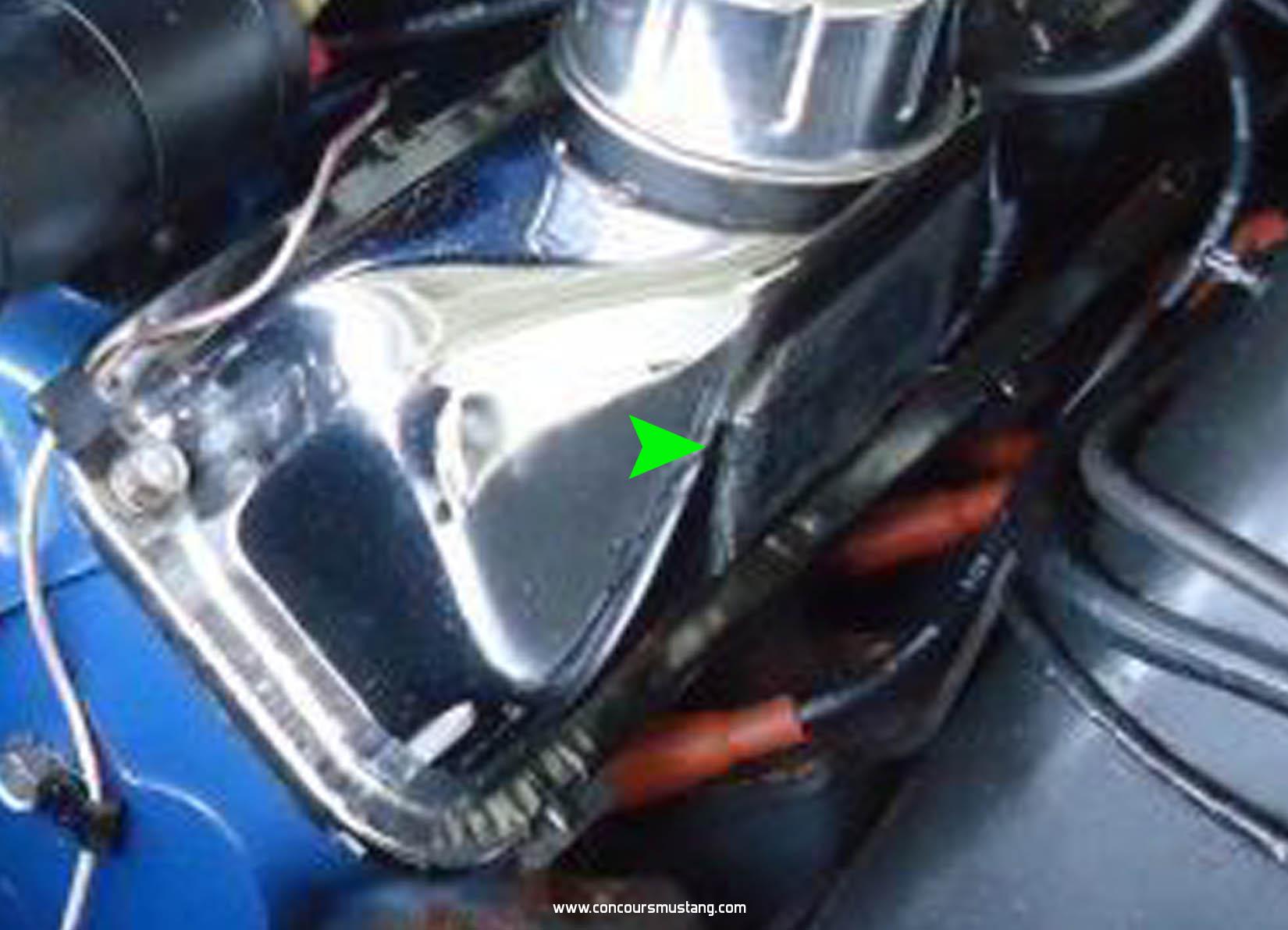

So a chrome valve cover car ..
The emission/timing striker goes on the drivers side valve cover as mentioned above.  It was applied at the engine plant so where the car was built doesn't come into play in answering this question. But thanks for including it anyway ;)  Same location fro a 390 also
Only the service decal goes on the  drivers side  shock tower
You didn't include when your car was built and it appears there are a few different trends (with the service decal) depending on the time period )
Of course many owners have copied other cars from other plants and builds - see them all the time on the internet and at shows :(
Couple of pictures to help illustrate

Yes; OE chrome valve covers.  Would the valve covers also have a date stamp ?
As mentioned above yes like most stamped steel parts. The plating like paint can make some a little difficult to read but on others its pretty easy.
The oil filler cap in the pictures has a plastic elbow.  Is that OE correct or should it be the metal elbow ?     Thanks,  Brian
The metal verses plastic elbow has been something tossed back and forth over the years. Looking at my collection of pictures the very early cars like your all have the metal elbow on them (9T102221, 9T102871, 9T119655)
