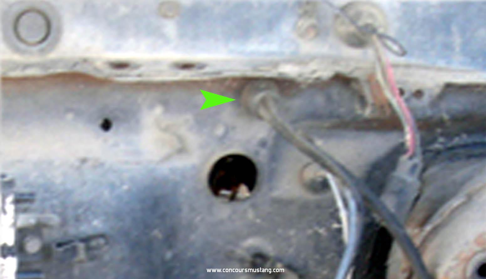

Ok 70 Mach 1 351c 4bl Metuchen plant and not an original AC car but has AC now. On the first pic posted with all the numbers there is no hole to the left of number 11 and above number 3 on that car. In the pic of the car with the red jack stands there is a hole there and another hole to the left of that with the rubber plug. Anyone know what either hole was for or which cars had those?
Secondly mine has the hole to the left of #11 but has this funny looking plug in it (the third picture).  I am beginning to think it is not original?  It has two holes in it that are open right through to under the dash.

« Reply #8 on: June 03, 2014, 09:30:32 PM »
Just for reference, right cars or not the hole I am trying to identify isn't even on the picture with all the numbers, and looks to be on the red jack stand picture (although I am not sure which one, the one with the grommet or the one without because I only have one). But this hole I have I believe is left of number 11 and above 23 on the flat part in the first picture.
My picture shows the rubber plug sticking out an inch or so with two smaller holes in it.
Jeff here is all the info from my Marti:
Mid year, 351 4V, Auto, no AC, with PS, P/disc  and a non- Calif sent car.
Ok now we can get to work

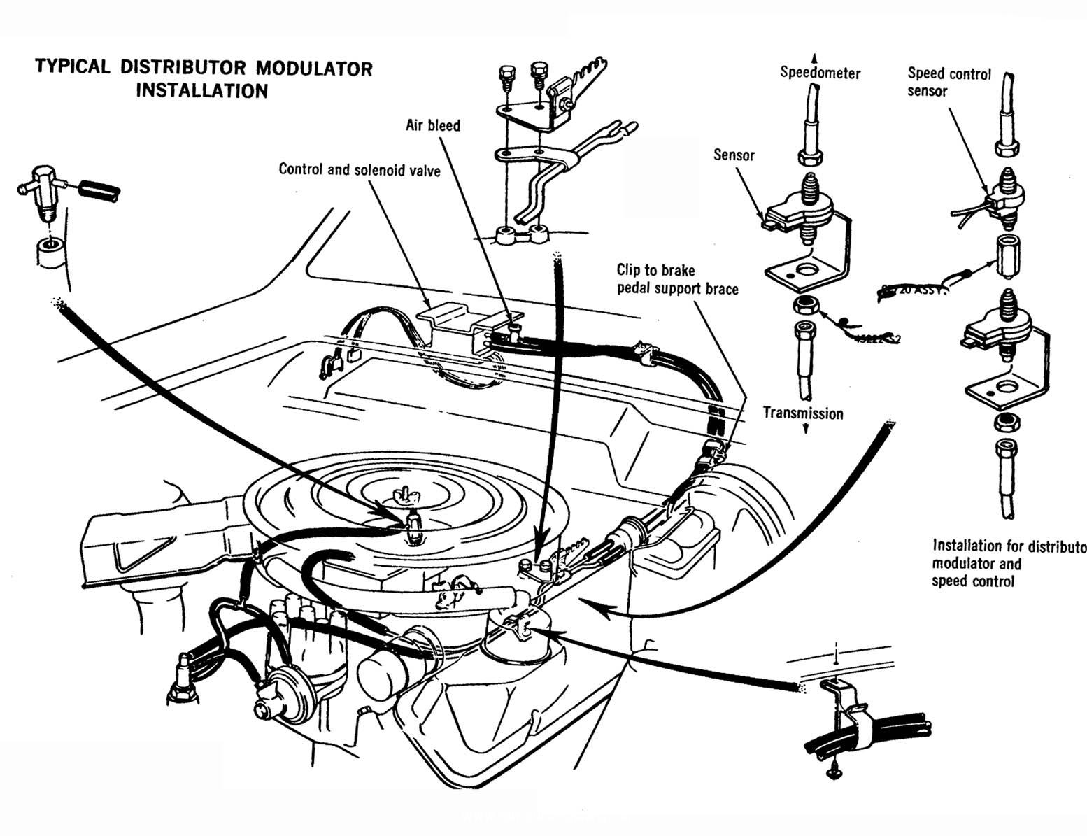

The rubber plug you have appears to be a buckhead plug that seals and holds a pair of rubber vacuum lines that pass through the firewall at that location
like this example
On other cars it simply had a rubber plug installed
Believe this is part of /related to the Dist-O-Vac system installed on M code automatics
« Last Edit: June 03, 2014, 09:36:17 PM by J_Speegle »
  • Posts: 24866
Re: 70 mach firewall hole
« Reply #9 on: June 03, 2014, 09:45:10 PM »
From an upcoming (read need to get to it as well as others) Article for the Library (stopped at 69 so far) showing the system, those lines and the plug

« Reply #10 on: June 03, 2014, 10:15:42 PM »
Thanks Jeff you are a genius that's what it has to be.  I assume it is empty because one of the following reasons, it is now a c6, has petronix, and a Holley 600 electric choke carb?  This all started because I was looking for a hole to run a wire to the coil for an aftermarket steering wheel tach.  Just so happened to find that nice little "buckhead" plug as you call it!  Then it made me nervous that it was too perfect and still open and not sealed.
