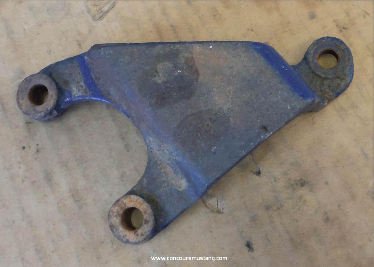

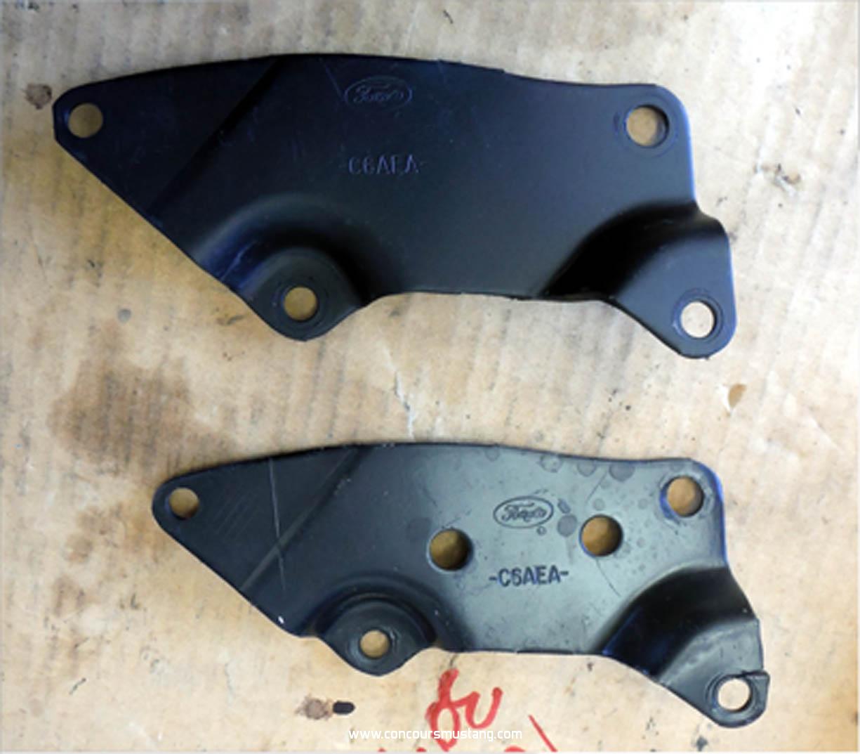

Here is the bracket I bought;
In my junkyard wanderings over the years, this style without holes is what I have seen most often on 1967 Fords (non-Mustang). The same bracket with the two holes, I have consistently found on 1966 pickups, T-Birds, and other Ford Mercury with FE engines.
Draw your own conclusion, the two styles of alternator mounting bracket may have been used during 1967 in California or other areas where thermactor was required on a Mustang.

Looks like I've  got a third version
Will post once I get the chip out of the camera. Like the version with the holes and the oval  FoMoCo  version along with the short engineering number (with the odd dashes at both ends)
So possibly ?  the same supplier ?

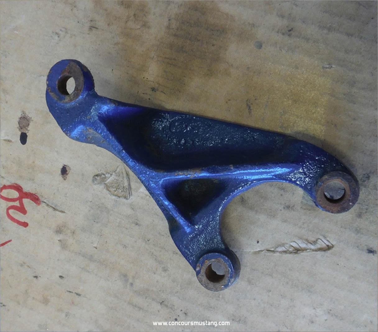

Took one of the Thermactor pump rear cast mounts out today so here is a picture of one of those. Attached to the engine when it was painted like the small block versions

Yours is for a FE - we're just discussing if the holes or non- holes is for a specific application, just a different supplier or something else. We need to dig a little more IMHO for any conclusion if we'll find one in the short period
There are several Small block pump brackets on the bay now. Are those correct for a Big block also? They appear to be one piece as opposed to the two you pictured Jeff. Or are they just bolted together?
No small block and big block are completely different. For Mustang the small block used a one piece cast iron mount for both the alternator and thermactor pump. The big block used the stamped steel front mount for the alternator and thermactor pump and a much smaller rear cast mounting bracket (shown above) for the rear mounting of the therm pump

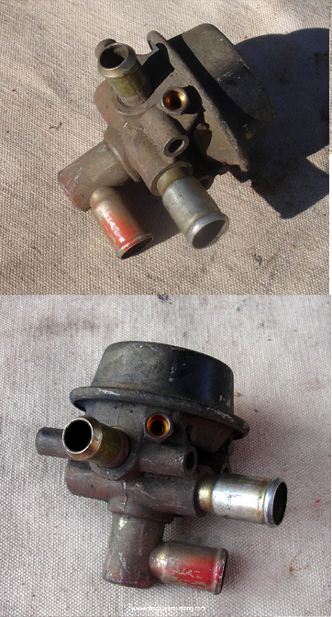

Since your doing a 67 Shelby the one small block piece you will need is a diverter/backfire valve with three ports - not the regular Mustang 390 (2 port) version.

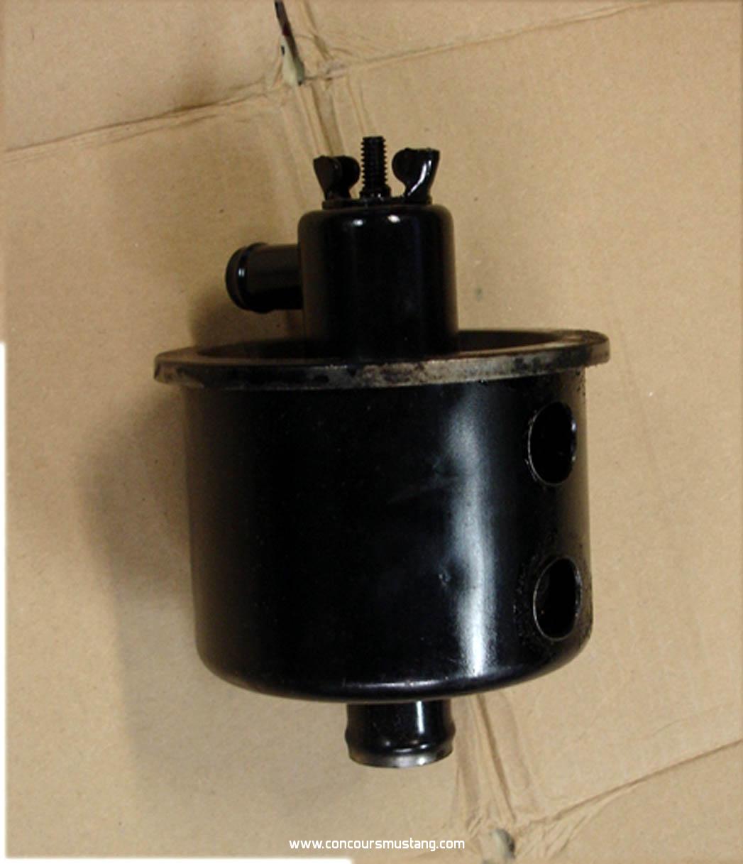

You've reported you already have picked up a filter canister - that was originally a 240 6 cylinder piece  adapted for the Shelby big and small block application likely IMHO due to the open element air cleaner that got certified on these cars in California

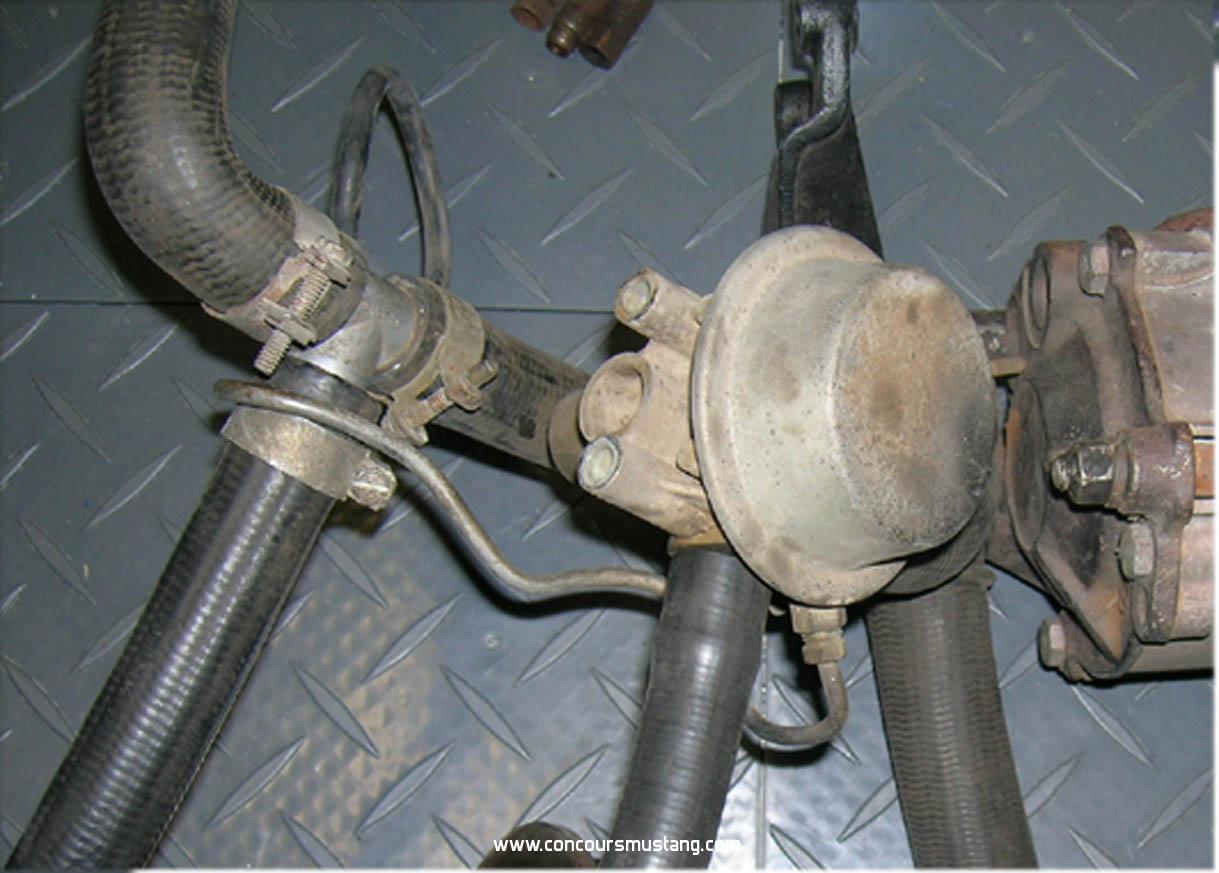

Is the wire hoop running over the hose just to hold the hose in position?

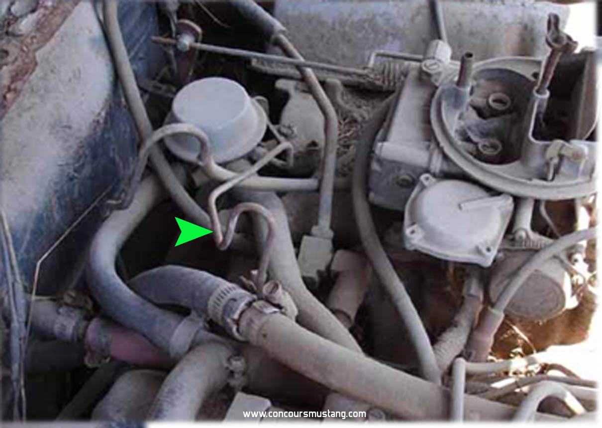

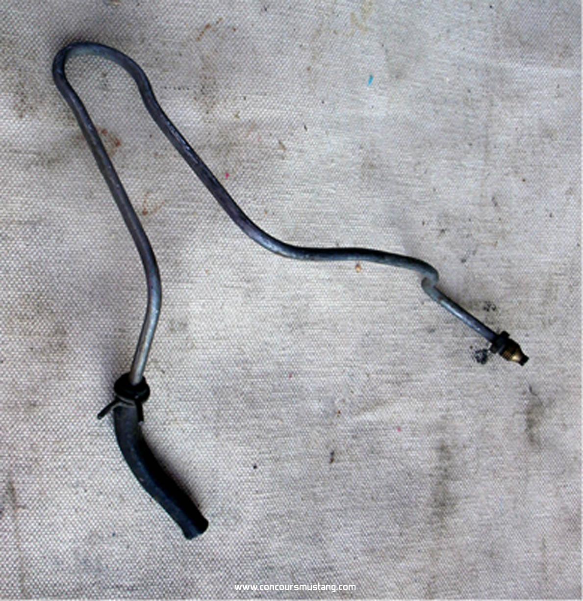

Not a wire but the small vacuum hose - just reused/repositioned on the Shelby's. The loop is similar to the distributor advance line (and that loop) used on the early Mustangs. Thia one attaches to the backfire valves small port on the side  Not unusual to find them bend all out of shape though the shape was modified a little from the Mustang application
Odd angle but here is one attached to the valve
And one on a 390 Mustang/Cougar

Wow, that vacuum tube has a tortuous path from point A to point B!
I don't have the add delete sheet, where would get one?
Oh I have been using this screen name ever since I got on the internet;
That vacuum tube route in that picture would not be applicable to your particular Shelby application .  The delete sheet was for a series of Shelby cars built all the same way (with the exception of color)not your particular car like a conventional build sheets. I have yet to find or hear of a conventional build sheet found in a 67 Shelby although it was no out of the ordinary to find a add+delete sheet in one. They were typically found in the car under the carpet.
