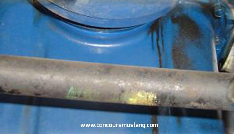

When I restored my 68 CSGT "S" 390 with 4-sp, PDB, PS (non AC) and the GT option a few years ago it was missing it's sway bar. It had front coil springs with green and yellow stripes which I believed to be original (I've owned the car since 1976 and sitting motorless since 1978). I found a .95" sway bar with green and yellow stripes and put it on the car. Was this the correct bar? I assumed it was because of the color stripes matching the coils but after searching here it appears the bar was for the competition suspension option which was not listed on my Marti. I've decided to return the car to it's original configuration (presently has incorrect drivetrain) and would appreciate any help.

The color markings match the markings typically found on a GT front sway bar (has nothing to do with any other color marking combinations) though the diameter is not normal for the standard GT application. Its possible that the provider marked some sway bars incorrectly and they were shipped to the plant and installed since workers on the line would only look at the colors before slapping them in a car.  Of course it can be difficult to measure a sway bar and things like rust and goop can add to the size if you didn't get it down to metal before you measure  Just in case ;)
Looking at 1968, Ford didn't list competition suspensions in their parts catalogs but showed a .858 as being the standard GT  or improved handling front sway bar and the .958 as being installed in a K code 67  and GTs with the "maximum handling package" (what we refer to as the competition suspension in 67.  68 289 4V GT's used an even smaller front sway bar (from a page dated Feb 68)
Its a stretch - but a possibility IMHO. I would change it out though, as you did, since you were not the first owner and can be really sure its original to the car. By 73 allot of things were altered and changed on these cars especially when they were big block 4 speed GT's for example ;)

The bar was in very good condition and the .95" and green-yellow stripes were easily discerned....Don't know for sure what year bar it is, though from looking around I believe it to be a 68 bar.  So if I understand correctly, My 68 390 GT should have green-yellow marks on a smaller .858" bar? Also... are the green-yellow marked springs correct? From my reading here I seem to remember the green-yellow were the highest rated at 1820? Would that make my coils the competition suspension ones? One more thing, If I decide to leave the .95 bar on are the inner sway bar brackets pictured the right ones to use? I ordered new bushings for it and used their brackets which don't have the wrap around....

.......... So if I understand correctly, My 68 390 GT should have green-yellow marks on a smaller .858" bar?
Just reporting what Ford was using to service the original bar with in 68. Since the page was printed while they were still building the cars one might assume that they would replace with what they were using on the line - always a slight chance of a misprint.
Have no way to confirm. Have no 68 390 4 speed coupe buildsheets. Did check 67's for the heck of it and the green yellow front springs were installed on much heavier, thermactor equipped  and better equipped cars than your - based on the buildsheets I have. Looking through an April 68 front spring sheet currently to see what it decodes out to for a 68 390 4 speed coupe with only ps and the GT suspension package
Up date - Yes that April 68 page confirms that Yellow and Green is what they would have serviced your car with and as mentioned before - since they were still building the cars its likely IMHO to be the one original to your car. No reference to any " competition suspension"  just the normal heavy duty springs (which in Ford speak that year I believe meant GT if ordered that way. Buildsheets used the term G.T. Equip. Grp.
